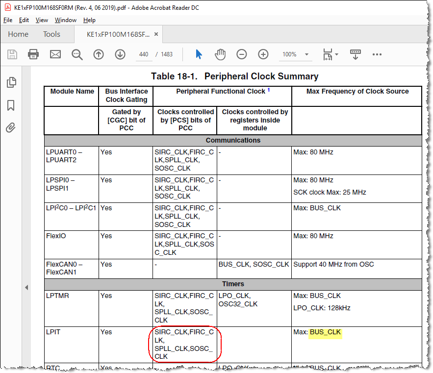

I need to know the extreme clock for the LPIT timer. I am using the KE processor at max speed.
In the electrical specifications I do not find the maximum clock for the timer. Maybe simply I can use whatever clock I want.
I need to get a clue where this information is mentioned.

According to the description of "Table 18-1. Peripheral Clock Summary", the Max Frequency of Clock Source is BUS_CLK for LPIT.

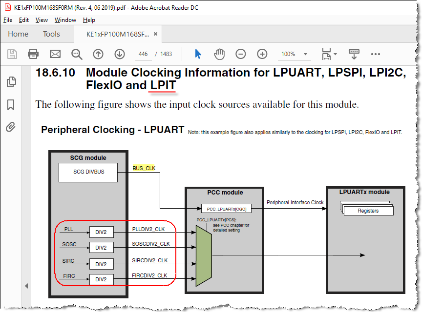

I am not sure which clock source have you configured for LPIT. You may need to check frequency of these clock source by yourself.
18.6.10 Module Clocking Information for LPUART, LPSPI, LPI2C,FlexIO and LPIT.png

That's it.
I did not find.
