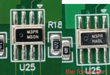

We ordered MPL3115A2   ,but we found the marking is different with the former ordered part,the part second line marking is ‘MSON’,the former part second marking is 'HAOL', pls see the following pictures. When we use the part,there is a short circuit. So we  want to confirm the part we receive is correct or not,thanks.

please find Marking code attached. The second line only defines date of assembly and assembly lot code. There is no difference in function of the sensor with different second marking line.
