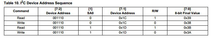

Dear all,
     Here I am just trying to communicate the MMA8452Q through I2C from Kinetis K40. The device address is given as 2A in WHO_AM_I register. But in the Datasheet of MMA8452Q they have given the device address as 0x3A and 0x3B. What is the actual device address to be programmed in the I2C1_D register in K40. Also pls let me know thw use of SA0 pin or bit.
Abulhasan
1,348 Views
Hui_Ma
Hi Abulhasan,
The MMA8452Q datasheet with below I2C device address:
You also could refer Kinetis TWR-K60D100M board I2C example code, which SA0 value is 1 and MMA8451Q device address is 0x1D.
For the I2C communication, it use below definition:
#define I2C_ADDR_MMA8451 (0x1d<<1)
