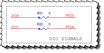

From MKW01xx Reference Manual, Rev. 2:
4.4.1 Additional Transceiver Status Signals
The MKW01Z128 transceiver has a total of six outputs (DIO5:DIO0) that can be programmed as status  indicators:
  • DIO1 and DIO0 are connected to MCU GPIOs, PTE3 & PTE2, internally to the package. For certain software configurations, improved performance can be obtained by connecting to additional GPIOs, PTC4, and PTC3, off chip. These connections are used by applications software in packet mode.
Does it mean use of LLWU (i.e.SyncAddress, CrcOk,... ) on PTC4, PTC3 to wake up sleeping MCU when transceiver do radio RX duty cycling or anything else ?

Hello Pavel:
I don't know the meaning of that "improved performance", but yes, I suppose you could use those flags (SyncAddress, CrcOk, FifoFull, FifoNotEmpty, etc) as wake-up sources, as long as you configure properly the LLWU unit of the internal MCU.
Now, as for why it says specifically PTC3 and PTC4, I think this is because of the connections in the Modular Reference Boards (MRB-KW0x: Modular Reference Boards for Kinetis KW0x Family of MCUs). Check this:
Regards!

It mean that if you want to use DIO1 and DIO0 in enhanced mode, you should route these signals to PTC4 & PTC3 pins, instead use them on default pins (PTE3 & PTE2).
The reason for this is explained on 8.1 LGA Package Maximum Ratings in the datasheet MKW01Z128:

thank you for clarification, yet it is still unclear to me, why I have to route them specifically to PTC4 and PTC3 (or why not just pull them up/down internally on PTE).
