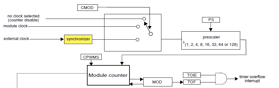

Hello, I'm having some trouble to use the TPM as a pulse counter in VLPS.
In RUN mode it counts the pulses, but when I put in VLPS it stops counting.
I'm using the input pin PTE16 - ALT4 (TPM_CLKIN0).
Some question, do the TPM source clock needs to be active in VLPS to count pulses? Isn't it an async operation? Cause the TPM clock source is 'kClockTpmSrcPllFllSel', which is disabled in VLPS.
Thanks in advance.
EDIT: Ok, when I change the clock source to 'kClockTpmSrcOsc0erClk', it works normally. But now it is generating a wakeup interrupt every ~60s, which is strange, since the interruptions are off. I'm using an external xtal at 32.768kHz as the clock source.

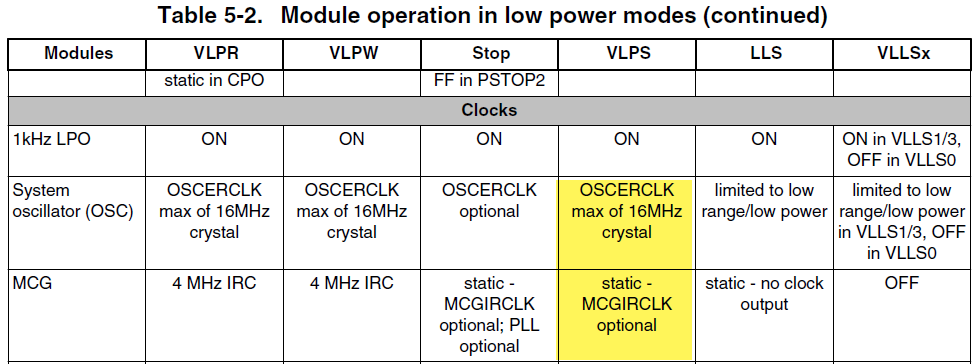

gerardo_rodriguez
Hello Giancarlo,
The TPM external clock is synchronized to the TPM counter clock, so when you selected 'kClockTpmSrcPllFllSel' (disabled in VLPS), the external clock was not being synchronized. You can see in the following table that the OSCERCLK is enabled in VLPS, so that is why with this clock source it works correctly.
In the Figure 27-1. TPM block diagram, you can see the synchronizer of the external clock.
About the interrupt, can you verify that the TPMx_SC[TOIE] bit is set to 0? You could also try, disabling the interrupt from the NVIC module with the INT_SYS_DisableIRQ(g_tpmIrqId[instance]) function.
