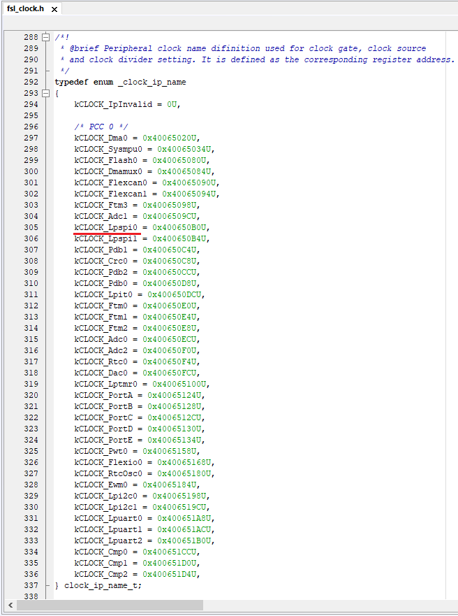

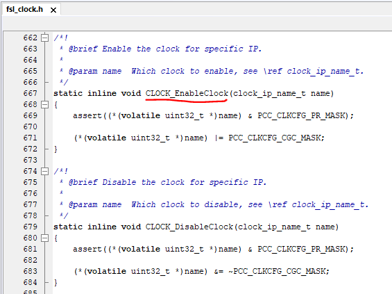

Robin_Shen
Hi John,
CLOCK_EnableClock(kCLOCK_Lpspi0); can be used to enable the clock gate of LPSPI0.

johnadamson
Okay, I think I see what the problem is, but it only raises more questions.  The code for CLOCK_SetIpSrc in fsl_clock.h is:
static inline void CLOCK_SetIpSrc(clock_ip_name_t name, clock_ip_src_t src)
uint32_t reg = (*(volatile uint32_t *)name);
assert(reg & PCC_CLKCFG_PR_MASK);
assert(!(reg & PCC_CLKCFG_INUSE_MASK)); /* Should not change if clock has been enabled by other core. */
reg = (reg & ~PCC_CLKCFG_PCS_MASK) | PCC_CLKCFG_PCS(src);
* If clock is already enabled, first disable it, then set the clock
* source and re-enable it.
(*(volatile uint32_t *)name) = reg & ~PCC_CLKCFG_CGC_MASK;
(*(volatile uint32_t *)name) = reg;
Tracing through it, I realized that the next-to-last line does indeed "first disable it", but the last line does NOT "then re-enable it".  If I change the last line to:
(*(volatile uint32_t *)name) = reg | PCC_CLKCFG_CGC_MASK;
the later code doesn't hard fault.  Because, of course, the clock for LPSPI0 was never getting enabled before and now it is.
So...am I missing a major step in my initialization, 'cause otherwise I don't get how anyone's code ever works.
John

johnadamson
Yup, that was it.  In trying to duplicate the functionality of LPSPI_MasterInit, I missed that line.
