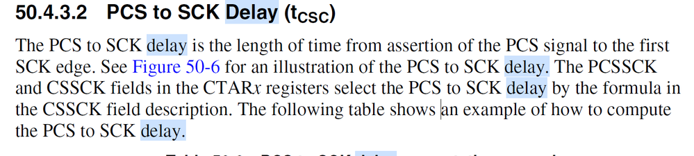

nxf58904
According to the picture above,there has a programmable delay between assertion of the PCS signal to the first SCK edge.
It seems this cause a 1us delay.
The delay can be set from register CTAR when as a master or CTAR0 when slave.
More details get from reference manual.

tobiasoswald
Hi Jianyu Chen,
thaks a lot for your reply.
If i get you right, you are referring top the SPI peripheral internal delays. As far as i understand those delays, they don't come to effect in this particular case.
Although i use the Pin assigned to the PCS-Signal of the SPI, which happens to be PC5, i don't use the SPI-Internal interrupts.
I chose to use the Port-Based interrupt (PORTC_PCRN5 field IRQC = 1001), so when the SPI frame is done, PCS goes high which triggers the external Port Interrupt.
What i observe is a 1µs time delay between PCS going high and the controller entering the ISR.
Tobias
