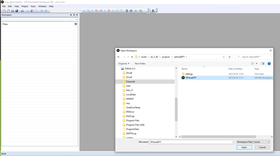

Q1)Which IDE should be chosen for metering applications?
>>>>The project is based on IAR IDE. You can unzip it to a directory by double clicking the *PHMET_R4_0_1_IAR.exe
After unzipping, the directory will be generated:
C:\Freescale\KM256SW1PHMET_R4_0_1\build\iar_7_40\projects\1phmetFFT
You can use the IAR to load the project to IAR
Because my IAR license has expired, so I have error when I compile the project.
Q2)How to incorporate metering libs like Application note software into those selected IDE's?
>>>>The FFT library is dependent the compiler, we have three library format based on iar,armgcc(Keil tools) and gcc. I copy the table from an4255.pdf
Q3)Also, in DRM163's SW part,KM256SW1PHMET_R4_0_1_IAR.exe, I can see IAR Toolchain with number of math/frac/meterlibFFT files in it. How to start with it?
>>>>pls refer to Q1
Hope it is helpful

GanesanGuru
Hi @xiangjun_rong ,
Thanks a lot for your aid in explaining that the IDE was IAR. I was facing a tough time in analysing them. Also I'm indeed very happy for your another another highlighted hint, regarding the toolchain support/integration table in AN's.
  1. Hence, from AN4265SW I can create a project in Keil IDE (armgcc) / mcuxpresso IDE (gcc) and can add those integration table mentioned header & archive files and can create projects. Am i right @xiangjun_rong ?
Just being curious, the downloaded Software File for AN4265, - Filter based - has header & archieve files for all IAR/ARMCC/GCC Toolcha...
  1. Similarly, form where can I find/download the software files for other application notes like AN4255.pdfAN4847.pdf?
  2. If I can locate those in future, am I free to incorporate the mentioned integration files in chosen IDE's like  Keil IDE (armgcc) / mcuxpresso IDE (gcc) ?
