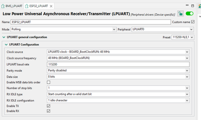

I'm on a custom board with a Kinetis MKL33Z256.
This board use many UART.
The UART0 is used to communciate with a Wifi module (ESP32) through AT command on serial port.
For now, I start to devellop without activate the ESP32 then no characters was received/sent on the UART0.
All is Ok, the project is configured on "SDK Debug Console -> Semihost console" then when I made printf on the C code, I see the text into in the MCUXpresso console.
My question is how this work with Serial UART0?
Because since I activatet the ESP32 module, I send and received character on the UART0, but I get an Hard fault:
I suspect there is a conflict between the UART 0 used and the console.
I do not know exactly how work the "debug console" and the interaction with UART0??
This is my UART config
Is somebody can help me?

I found my mistake.
Into the UART interrupt callback, I call again HAL_UartReceiveNonBlocking to read the next byte.
But I changed by mistake the pointer on a global variable buffer to a local buffer (into the stack)... This is why, when data received, it was written into this stack at a time where this address was used for other thing...
Sorry for that.
