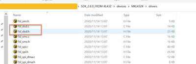

Hi everyone,
I want to use the SLCD driver of the SDK 1.3 with Kinetis 3.0.  This is a barebone approach.   I need help with instructions on how to import the needed source and include files.  I also need any properties paths, library paths, and includes.
Please no examples, I  already have seen examples of the KL43Z and KL46Z.
Thank you,
Neil

   Your SDK1.3 is really very old and it is out of support now.
   Please use the newest SDK which can be downloaded from this link:
https://mcuxpresso.nxp.com/
  I have checked the newest SDK for KL43, it contains the slcd examples:
SDK_2.8.0_FRDM-KL43Z\boards\frdmkl43z\driver_examples\slcd
Already have the fsl_slcd drivers.
Wish it helps you!
