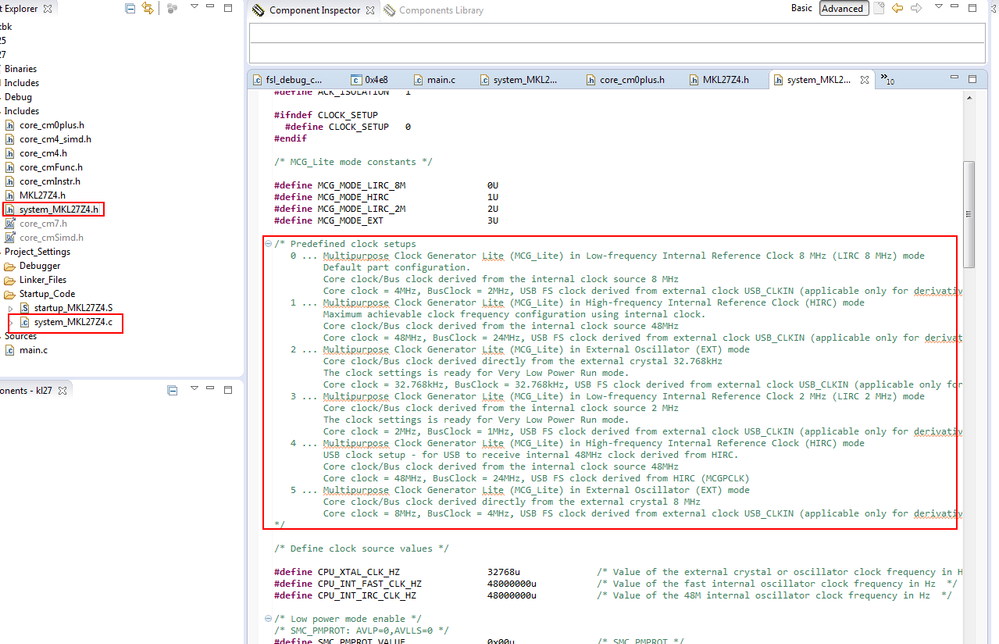

      I test your question on our FRDM-KL27, because this board don't have the external 10Mhz crystal, then I just test the HIRC and LIRC, the clock is configured like this :
HIRC
    core clock: 48Mhz, bus clock: 24Mhz
LIRC
    core clock: 8Mhz, bus clock 4Mhz
  Then I output the bus clock to CLKOUT(PTC3), when choose HIRC, then the bus clock output 24Mhz; When choose LIRC, then the bus clock output 4Mhz on PTC3.
The attachments are the test project based on KDS3.0 and KSDK1.3.0, you can test on your side, and check your configurations.
Wish it helps you!

kerryzhou
Hi Bob Paddock,
      My code is like this :
void LIRC_8M_BUS4M(void)
      SIM->CLKDIV1 = 0x00010000u;    /* Set system prescalers */
      MCG->SC = 0x00u;              /* Set SC (internal reference clock divider) */
      MCG->MC = 0x80u;              /* Set MC (high-frequency IRC enable, second LIRC divider) */
      MCG->C1 = 0x42u;              /* Set C1 (clock source selection, int. reference enable etc.) */
      MCG->C2 = 0x01u;              /* Set C2 (ext. and int. reference clock selection) */
      OSC0->CR = 0x00u;            /* Set OSC0_CR (OSCERCLK enable, oscillator capacitor load) */
      while((MCG->S & MCG_S_CLKST_MASK) != 0x04U) {} /* Wait until low internal reference clock is selected as MCG_Lite output */
void HIRC_48M_BUS24M(void)
      SIM->CLKDIV1 = 0x10000u;    /* Set system prescalers */
      MCG->C1 = 0x00u;              /* Set C1 (clock source selection, int. reference enable etc.) */
      while((MCG->S & MCG_S_CLKST_MASK) != 0x00U) {} /* Wait until low internal reference clock is selected as MCG_Lite output */
void CLKOUT(void)
      SIM_SCGC5 |= SIM_SCGC5_PORTC_MASK;
      PORTC_PCR3 = PORT_PCR_MUX(5);
      SIM_SOPT2 |= SIM_SOPT2_CLKOUTSEL(2);
void HIRC_48M_BUS24M(void): use HIRC 48Mhz as the source for core clock, then core clock is 48Mhz, bus clock is 24Mhz, I can get the 24Mhz from PTC3.
void LIRC_8M_BUS4M(void): use LIRC 8Mhz as the source for core clock, then core clock is 8Mhz, bus clock is 4Mhz,, I can get the 4Mhz from PTC3.
I don't know why you get 48Mhz on your bus when you test on your side, so please create a new barebone code( not choose PE on KDS3.0), just add my function and call function HIRC_48M_BUS24M or LIRC_8M_BUS4M, and test again on your side.

Hello Bob,
Which IDE do you use ?
If you use KDS, about the configuration of clock you can refer to
If you use other IDE , it should also have the same clock configuration files , you can refer to .
Hope it helps
Alice
