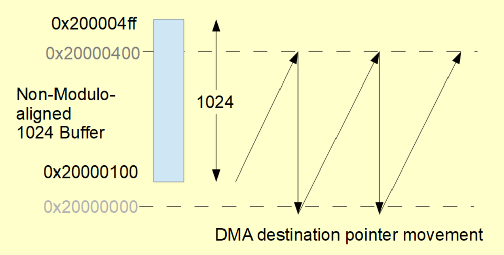

This is how to do free-running DMA on UART 0 on the KL26.
I show the code that I use and then the code under its bonnet which is performed (just showing the DMA part).
- UART errors need to be cleared otherwise further reception is blocked - this means that you should handle error interrupts and clear the cause so that it can continue. Actually I never experienced it erroring when using Rx DMA but it is a valid point and worth testing with intentionally bad reception.
- DMA overflow doesn't need to be detected and BCR does not roll-over - it just stops, therefore BCR is not used.

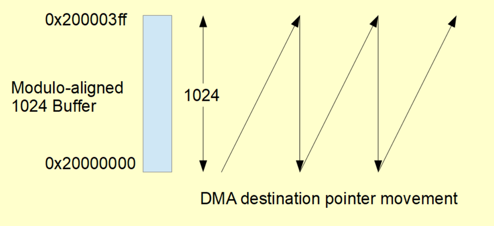

1b. Your circular buffer must be a modulo size and it must be modulo aligned - eg. above it needs to be located at an address in SRAM that is divisible by 1024.
uTasker queue driver uses
ptTTYQue->tty_queue.QUEbuffer = (unsigned char *)TTY_DRV_MALLO_ALIGN(queue_size, queue_size)
to get aligned memory from the heap but you can also do something like:
#define RX_BUFFER_SIZE 1024
unsigned char buffer[RX_BUFFER_SIZE + (RX_BUFFER_SIZE -1 )];
unsigned char *ptrBuffer = buffer;
while ((((unsigned long)ptrBuffer%RX_BUFFER_SIZE) != 0) {
    ptrBuffer++;
to get a pointer to an aligned area (or use the linker script or other non-portable methods to reserve aligned space for use).

This means that it is the DMA pointer that is used to monitor reception progress - the DMA counter cannot be used with this DMA controller (although is the one used when working with eDMA based types).
There is one variable maintained to remember the pointer value the last time that it was checked [ulDMA_progress[channel]] and note that the DMA reception length is always (re)set to its max value again each time the polling/checking is performed due to the fact that DMA controller doesn't have a "real" free-runnning mode (as the eDMA does) and it will otherwise count down to zero and stop at some point.
Each time 'additional' data is detected the circular buffer's character counter is incremented by the amount.
This is then decremented when the user actually "consumes" the data.

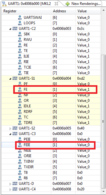

My modem generates framing errors, so I have to clear the FE flag.
if (UART_S1_FE_MASK & baseUART->S1)
{ // clear FE flag
baseUART->S1 |= UART_S1_FE_MASK;

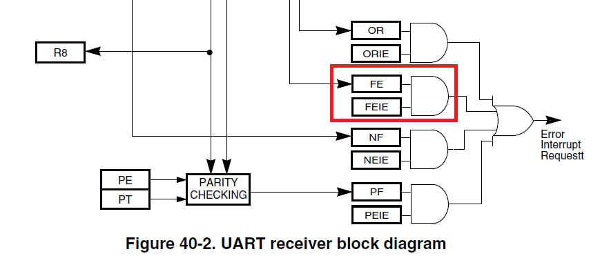

The C3.FEIE bit is not set, so why is the S1.FE bit getting set?
See below.
Can somebody explain this to me why S1.FE is getting set when C3.FEIE is not set?
Bruce
12,512 Views
danielchen
Please refer to the block diagram, FE and FEIE are independent of each other.

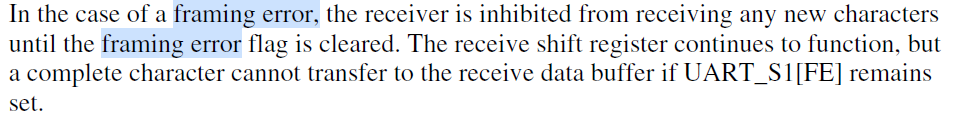

So, why am I getting a storm of DMA transfers (all 0x00) when the framing error occurs?
I have to write to U1.FE to end the storm.
Bruce
12,512 Views
mjbcswitzerland
Specialist V
Bruce

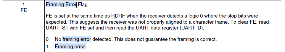

The framing error flag indicates that the UART received a logic '0' when it was expecting to receive a logic '1' at the end of a character. The flag is always in operation but its interrupt is conditional on FEIE.
When such 'errors' occur you need to clear them otherwise the reception doesn't recover - in some cases no more reception takes place and in your case it sounds as though the DMA is still triggered but the Rx data register is not updated.
To clear FE you need to read the status register (with it set) and then read the data register. [S1 is a read-only register and you may have managed to clear the flag with a read-modify-write, due to the read part]
It is possible that you have the framing error due to (slightly) mismatched Baud rate, or due to the way that your modem starts up (eg. a falling edge on the Rx input which remains in that state for the duration of a character will provoke this). You my need to ensure that your modem has fully started before enabling reception; clear any such flags where starting communication and use the framing error interrupt to trigger clearing the flag so that operation can continue.
If this happens during normal communication (and not just at initialisation) there will be a mismatch in settings so you need to check the timing to find out why.

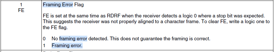

The modem is dropping its TX pin while it is powered down. That is when I get the framing error.
According the the manual, KL26 Sub-Family Reference Manual, Rev. 3.2, October 2013
To clear FE, write a logic one to the FE flag.
I see that UART_TransferHandleIRQ() in fsl_uart.c clears the error like you suggested.
/* If RX framing error */
if (UART_S1_FE_MASK & base->S1)
/* Read base->D to clear framing error flag, otherwise the RX does not work. */
while (base->S1 & UART_S1_RDRF_MASK)
(void)base->D;
The read modify write of UART1.S1, without the read of UART1.D appears to be working.
With the free running DMA, the timer code can't read UART1.D or it will cause characters to get lost from the middle of the UART data that was arriving when the timer fired off.
The manual and the code in fsl_uart.c don't agree.
I guess that the reason that UART.D is read is get rid of the bogus 0x00 so that the 0x00 does not end up in the ring buffer.
I bet the manual is correct, and the comments in fsl_uart.c are bogus.
The comment should have been
/* The framing error has put a bogus character into base->D.  Read base->D to clear the character so that it does not end up in the ring buffer. */
I expected more from NXP ......... very sad.

Beware that UART0 and UART1/2 are not exactly the same. If I understand correctly you are working with UART1, where this is true:
If you were using UART 0 the following would be true:
This suggests that you are referencing the wrong UART description in the manual -> you need chapter 40 and not chapter 39.
Note also
which explains (sort of) why you don't get new UART Rx values until the flag is cleared.
Mark
12,512 Views
bgraham
I did not notice the differences in the docs for UART0 and UART1. Thanks for pointing that out.
DMA fills the DMA buffer with 0x00 when the more data comes in.
When the until UART1.S1.FE has a 1 written to it, the DMA buffer fills with good data.
The DMA must be resuming the UART RX without the need for my code to read UART1.D.
My code worked by coincidence, instead of design.
Bruce

Assuming 1024 bytes aligned and 1024 modulo operation is enabled:
The destination starts at 0x20000000 and increments after each transfer. When it reaches the end of the modulo aligned area it automatically sets itself back to the first address again.
When I test modulo operation and a non-aligned buffer I see this behavior:
That is, it starts working without any problems in that it starts at the programmed address and increments. When the pointer gets to the physical modulo boundary (0x20000400 in this example) it recognises it to be the point to wrap around and it does a 1024 wrap to 0x20000000. This address is before the start of the prepared buffer. Further DMA transfers therefore write to addresses outside of the prepared buffer space and potentially corrupt other system variables.
The DMA controller is much simpler than the eDMA controller in some other Kinetis parts and I believe that the only effect of the modulo setting is on the address pointer behavior which causes it to quite blindly wrap at the programmed modulo boundary.
These are results from practical tests in modulo mode so I am therefore wondering whether you may in fact not be in the modulo mode or not have noticed the effect when testing short length data reception (before the wrap around occurs).
Once your HW is operating again it may be worth doing a check to ensure that the behavior is not as above. If you achieve modulo mode with wraparound being successful at non-modulo aligned addresses I would be interested in the exact settings so that I can repeat tests with them.
Mark

bgraham
That is unexpected.
I had a problem were the DMA BCR would change, but the DMA buffer had zeros at the end of the buffer instead of my data. I did not see the new data at the start of the buffer.
Maybe the BCR wrapped, and now my data was written to an address below the original DAR.
That might explain why my hardware appeared to stop working properly.
