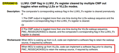

Celeste_Liu
Hello @carlos_takeo_ta ,
Thanks for your post. I think this may be related to ERR008010. Please check whether PMC_REGSC[ACKISO] is cleared and whether the corresponding flag of the comparator in the LLWU_Fx register is cleared. Correspondingly, it provides a workaround.
KL03Z Errata Link: KL03Z_1N86K
Hope it help you. If you have any further questions or need more information, please let me know.
Celeste

carlos_takeo_ta
Hi Celeste_Liu, thank you very much for the feedback.
I am not using the CMP comparator module in my project.
Do you think that even so, the ERR008010 errata would be relevant?
Anyway, could you show me what the code suggested by the workaround would look like?
Best Regards.

Celeste_Liu
Hello carlos,
You are correct. Since CMP was not used, it should have nothing to do with this errata.

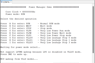

I would suggest you refer to the power manager demo under the SDK installation folder
SDK_2.3.1_FRDM-KL03Z\boards\frdmkl03z\demo_apps\power_manager
This demo application demonstrates the use of power modes in the SDK. and use source pin to wake up from VLLS3.
SDK download link: Select Board | MCUXpresso SDK Builder
Hope it can help you.
