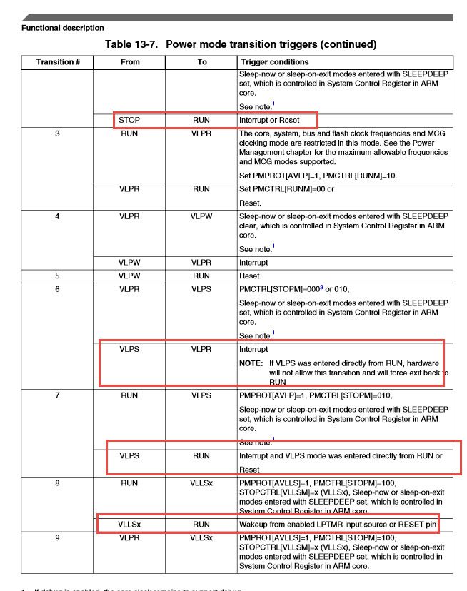

Hi Ralph Deffke,
    Whether can use the PTA7(IRQ4) and PTB0(IRQ5) to wake up the deep sleep mode, it is determined by which deep sleep mode you are using.
    In KL02, the deep sleep includes STOP, VLPS, VLLS1-3  low power mode.
   To STOP and VLPS mode, you can use the PTA,PTB interrupt to wake up the deep sleep mode, but to VLLSx mode, you just can wakeup from enabled LPTMR input source or RESET pin.
For details, please refer to the KL02 reference manual, page 174:
Actually, in our FRDM-KL02 sample code, there has a project about the low power, you can refer to it.
FRDM-KL02Z Sample Code Package
You can find the code from folder:kl02-frdm-demo\build\iar\KL02_LowPower_Demo
If you want to use PTA7 and PTB0 to wake up the Stop and VLPS mode, just configure the PORTA and PORTB and it's interrupt, but take care, you can't use PTA7 and PTB0 to wake up the VLLSx mode.

mjbcswitzerland
Specialist V
See the following:
http://www.utasker.com/kinetis/LLWU.html
However, note that the KL02 - as exception - has no Low Leakage Wakeup Unit.
If you want to wake up from deep sleep (but not low leakage) any asynchronous interrupt can be used.
IRQ_4 is PTA7 and IRQ_5 is PTB0 - most devices don't call tham IRQs but the KL02 only implements port interrupts on a reduced number of pins so they are named as PTyz/IRQ_x to make it clearer.
You can thus wake from a deep sleep mode on any edge on these ports.
The technique is the same as in the link apart from specifying PORT_INTERRUPT instead of WAKEUP_INTERRUPT.
Note further that it is possible to specify a unique user interrupt handlers for every pin, although the pins of a port actually share an unique interrupt vector.
