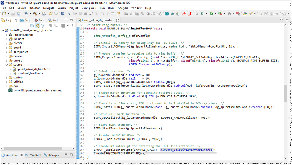

Robin_Shen
Hi shar2021,
Check the IDLE of "48.3.1.7 LPUART Status (STAT)".
48.3.1.7 LPUART Status (STAT) IDLE.png48.3.1.7 LPUART Status (STAT) IDLE.png
You can enable the Idle Line Interrupt by ILIE of 48.3.1.8 LPUART Control (CTRL).
Robin

Robin_Shen
Sorry for the delay!
Have you test the twrke18f_lpuart_edma_rb_transfer?
