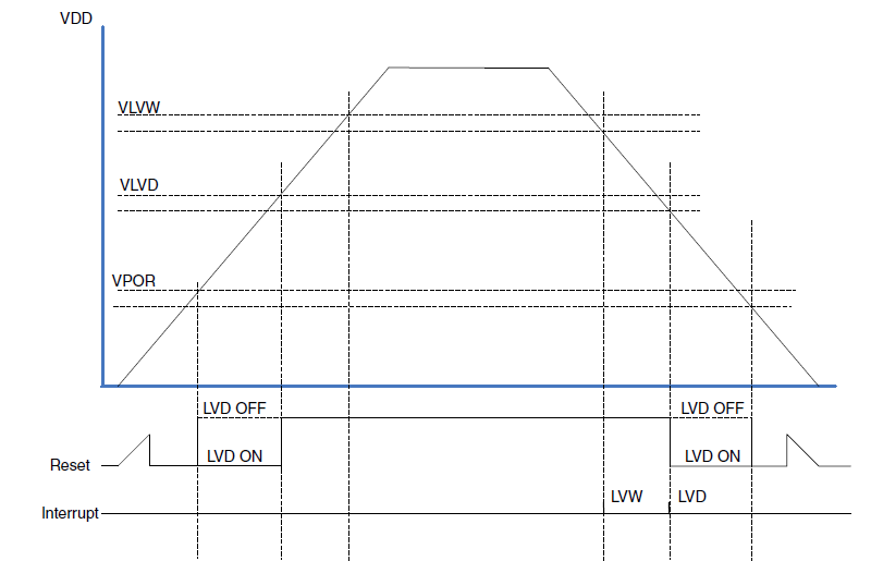

I want use LVW interrupt  to detect power off and save some data to eerpom(flexNVM), but the it can't into LVD_LVW_IRQHandler.
Set breakpoint in LVD_LVW_IRQHandler, in debug mode , power off MCU, the program can't run to breakpoint ;
Set breakpoint in HardFault_IRQHandler, in debug mode , power off MCU, the program also can't run to breakpoint ;

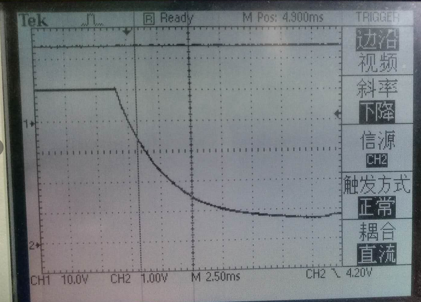

After power off the MCU, the +5V power can keep 1ms from 4V to 3V, why it can't work into interrupt?
Or how to store some status data at the power off ?

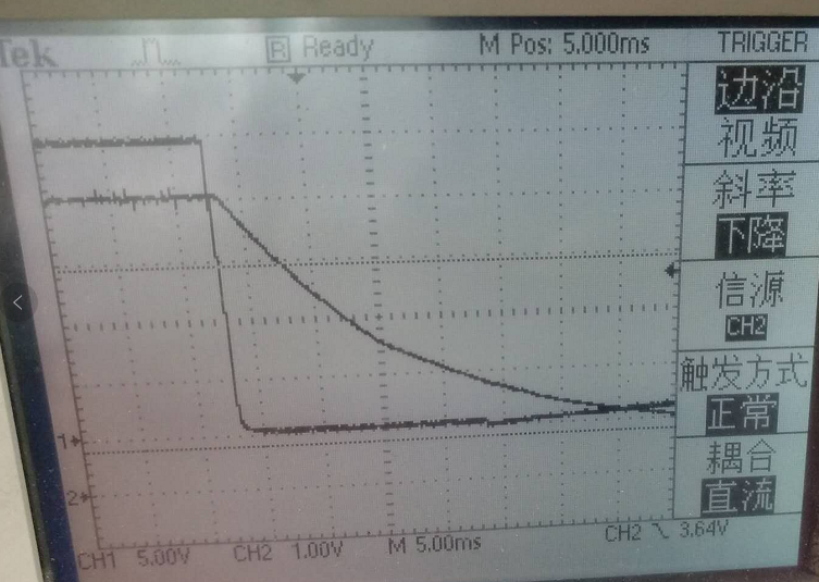

      After add a 470uF CAP to the MCU power, the LVW Interrupt work well .
      After power off the MCU, the power can keep 5ms from 4V to 3V.
