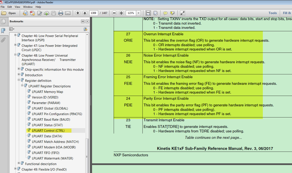

Is it right, that there's no interrupt source assigned in the MKE14F to the UART1 communication error?

Hello Michael Heidinger,
    About the LPUART1 error interrupt, you can check the reference manual, LPCUART control register, there have these errors interrupt:
Noise Error Interrupt Enable
Framing Error Interrupt Enable
Parity Error Interrupt Enable
Overrun Interrupt Enable
Wish it helps you!
Kerry

michaelheidinge
But NVIC is missing interrupt error, or do i see it wrong?

I see your point, in that while the LPUART has the 'error interrupt enable' bits, there is no independent vector for them --- but, as before, every error is again directly associated with an RDF indication --- all I can suppose is that the 'error interrupt' could give you an RX interrupt while your watermark has not yet been hit.
Since every error indication still involves reading from the DATA register, what are you hoping to gain from an independent interrupt vector (as opposed to just checking for any 'error indications' prior to data-register-offload in the RX interrupt handler)?

Which is to say there are no errors that are not directly associated with receiving a character (RDRF set), so it is necessary and sufficient to read LPUARTx_STAT prior to LPUARTx_DATA to ascertain 'error' associated with the RX interrupt.
