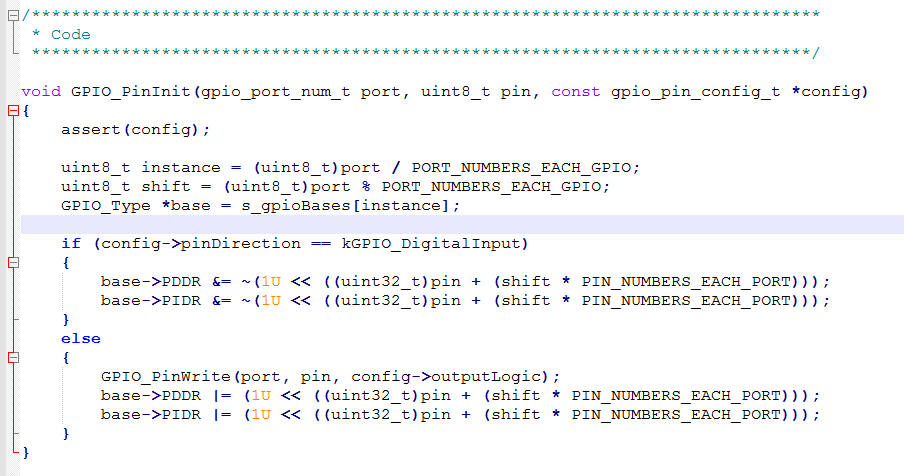

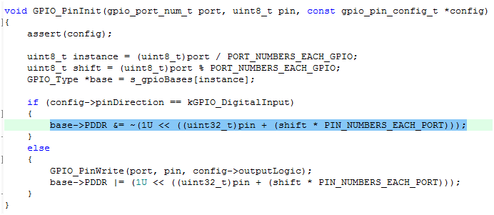

lifeng
SDK_2.3.0_MKE06Z128xxx4: fsl_gpio.c
for input setting, set PDDR OK,  not set PIDR, still disable IO input, read IO return 0.
set PDDR and PIDR for input IO
2,206 Views
Hui_Ma
Thank you for the info.
The latest MCUXpresso SDK for KE06 had fixed this issue.
Please check below GPIO_PinInit() function at <fsl_gpio.c> file:
Mike
