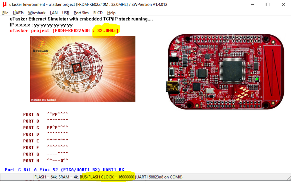

1) The default operation is from the FLL referenced to the 32kHz IRC, with a multiplication factor of 1024. Since BDIV is /2 this means that the core clock speed is about 16MHz, which is (by default) the same as the bus/flash clock.

KE04Z40 simulation showing operation at 32MHz core and 16MHz bus/flash (derived from 32kHz IRC FLL):
