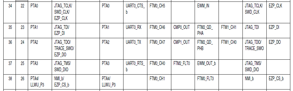

Trying to get more clarification how to use a bootloader on the MKV31F256VLH12 chip.
- Does it support ROM Bootloader?
- Does it support EZPORT Interface?
Looks like I can use the flash-bootloader application which requires to flash it into the MCU
Which Pins do I need to control to enter bootloader/EZPort mode?

The KV31F256 doesn't include a ROM Loader.
It does have EzPort - pins:
See EzPort Cloner reference and video:
https://community.nxp.com/message/598772
https://www.youtube.com/watch?v=5fI44hFcF18&feature=youtu.be
http://www.utasker.com/docs/uTasker/uTaskerEzPortCloner.pdf
KV31F loaders are available in the free open source uTasker project at links below.
