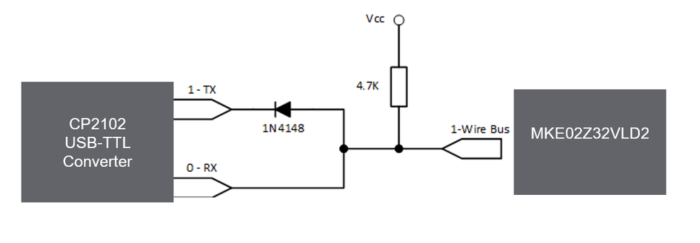

Question about circuit for Single Wire UART on MKE02Z32VLD2
MKE02Z32VLD2 and CP2102 I am trying to communicate with a PC using a USB converter and Single Wire UART, but there is an issue of loopback.
<My configuration>
1. My PC has CP2102 USB to TTL converter.
2. I configured LOOPS and RSRC MKE02Z Firmware for single wire UART
- UART1 C1 configured LOOPS bit and RSRC bit.
- UART1 C2 configured RE and TE.
- Controlled the direction using CS3 TXDIR bit.
3. I connected the CP2102 converter and UART1 TX pin referring to the circuit as an attached circuit diagram.
A problem has been detected in which the signal sent by the PC is returned back. It has already been confirmed by debugging that this is not a signal that MKE02Z responds to.
The red part indicates that the packet sent from the PC is looped back, and the green part is the packet that the MKE02 responds to.
How to solve the problem that the message sent from the PC is looped back in the attached circuit? or what's the exact circuit to do the MKE02Z32VLD2 Single Wire UART?
If there is something I'm doing wrong, please point it out and comment.

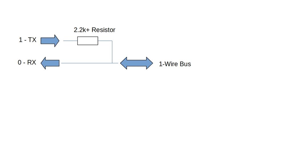

I think I can summarize the answers to your questions by saying with a 1 wire bus you're always going to have to be concerned with echo'd characters being received by the sender.  I would suggest that you don't think of this as a problem, it's a characteristic of a 1 wire bus.
There are two ways of dealing with this:
1. As mentioned previously, select the "remove echo" option on your software.
2. In my first reply, I noted that you can add an OR gate to your RX line to prevent received data from being echo'd back - you keep the "Digital Output" high until you want to transmit back:
I would consider this a sub-optimal solution because it requires another IO pin (and if you had two to spare, you would use a traditional UART with separate RX and TX pins).
The best solution is for the host software to filter out the echo'd bytes.
Again, don't think of this as a problem but as a characteristic of the circuit and adjust your design requirements accordingly.
Good luck!

It was helpful seeing the 1Wire UART circuit post and I can see now what the author is trying to accomplish but it's more complex than it needs to be AND depending on the hardware used, it may result in incompatible voltages on your IO pins.  Could I suggest that you simplify your circuit to:
It will perform the same function as your diode/resistor combination but it is more traditional and you don't have diode drop voltages to deal with.  You can probably go much higher than 2.2k for the current limiting resistor, but it's a good place to start - check the voltage drop across it to ensure that highs and lows are within your Vol and Voh range limits.
Regardless, you're going to have your input characters echo'd back to you with any of the three circuits discussed here.  In your Modbus software, did you look at the "Remove Echo" option?  I just did a quick look at the datasheet and that's listed in Section 4.7 (Modbus Poll user manual).  I think that will remove the echo'd bytes and give you wnhat you want.
Good luck!

As you said, I removed the diode and pullup resistor and replaced it with the simple circuit that only connects the resistor to the tx line. As you said, there is also an echo message in this simple circuit.
As you commented, I can remove the echo that sent messages are looped back after I enabled the echo cancellation is enabled in the Modbus poll's advanced menu.
so I have an additional question. Does communication with single wire UART communication between MKE02Z and PC always echo? or is it a problem with these circuits? Is there a way to completely solve the echo problem by further modifying these circuits? Is removing echo messages from software the only solution?

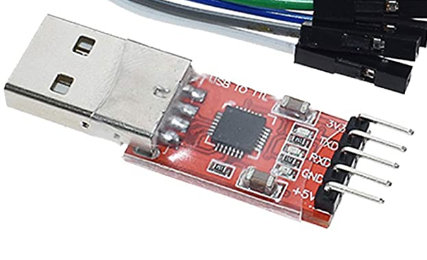

  1. What is the actual USB to TTL converter (module) that you're using?  I'm guessing it's not the chip directly because I just looked at its datasheet the pins you've labeled don't match.  I'm asking because there's always confusion regarding TX/RX.
    1. From the CP2102, can I assume:
      1. "0-RX" is from the PC?
      2. "1-TX" is to the PC?
  2. Where did you get the connection circuit that you are using?  The diode on "TX" doesn't look right (discussed below).
  3. What is the software on the PC side?  Is it something that you control?
With the circuit that is shown in you should be getting the behaviour that you're experiencing.  Data from "0-RX" is passed to the MKE02 and the "1-TX" pin.  Data from the MKE02 is passed to the "1-TX" pin.
So, data from the PC will be returned to the PC and data from the MKE02 will be passed to the PC.
The only way to avoid data from the PC being returned to the PC is to place an OR gate which is controlled by the MKE02 - I presume that you don't want to do that because you're using a single wire connection and are IO limited.  This is why I asked about the PC's software - it needs to filter out what has been sent.
Also, I think the diode should be on the output of the "0-RX" pin (with the Anode facing the pin) rather than on the "1-TX" pin.  Having it on the "1-TX" pin does nothing but lower the high voltage going into the CP2102 by the diode drop.  Having the diode on the "0-RX" pin will stop you backdriving the "0-RX" pin with your data (looking at the datasheet, none of the UART outputs are open drain).

As per your advice, I tested the diode connection on the cp2102 RX pin line.
I tried adding a connection to the RX pin and the 1N4148 diode towards the anode as you advised. But the loopback problem keeps occurring. So, for just a test, I connected the RX pin towards the cathode of the 1N4148 diode to the RX pin. The loopback problem is removed, but I am unable to receive a response message from MKE02. It seems that no current is flowing through the RX pin on the PC side by the diode.
I have answered the question you asked me as follows.
1. The CP2102 UART to TTL converter is a converter product from the link below.
It is a USB converter and when connected to a PC, it recognizes it as a virtual COM port.
https://www.amazon.com/HiLetgo-CP2102-Converter-Adapter-Downloader/dp/B00LODGRV8
RX pin: receive pin from MKE02Z to the PC side
TX pin: transmit pin from the PC side to MKE02Z
2. I got information about the circuit from the links below.
I got the information from the link below, connected a 1N4148 diode to the TX pin, and put a 4.7KOHM pull-up on the TX PIN of UART1 of MKE02Z.
https://community.nxp.com/t5/Kinetis-Microcontrollers/1Wire-UART-circuit/td-p/931697
https://cnnblike.com/post/stm32-OneWire/
3. The software I used is a Modbus master software called Modbus Poll from the link below. By accessing the virtual COM port created when the CP2102 converter was connected, an 8-byte (01 03 00 0A 00 01 A4 08) message was sent from the PC to the MKE02.
https://www.modbustools.com/modbus_poll.html
Thanks again for the helpful reply.
