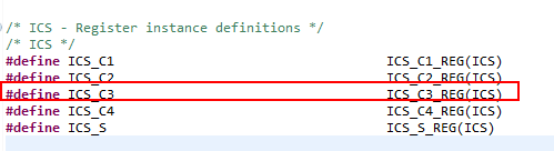

Hello Neil.
Which IDE do you use ?
You can check the header file after you create one project .
For example , in KDS IDE, you can directly use like this ICS_C3   , for it have define it in the MKE02Z2.h file :
If i misunderstand your meaning , please tell me ,thank !
Hope it helps
Alice

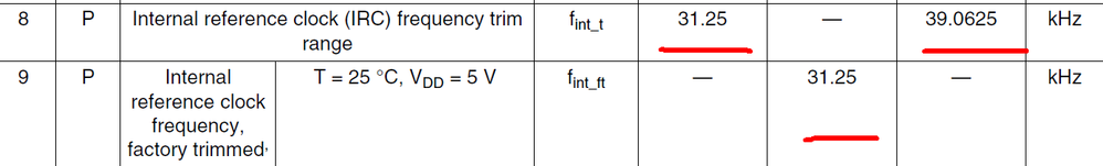

Hello Neil,
For the example of RM, in my opinion, the trim value is not calculated , it is provide
by the data sheet , from the ke02 data sheet , we can see that :
And we need not configure the register of ICS_C3, for one chip , the data has trimmed by factory .
Hope it helps
Alice

Hi Alice,
I did find that reference data sheet and see that the trim is 31.25, but I believe that trim value is from factory.

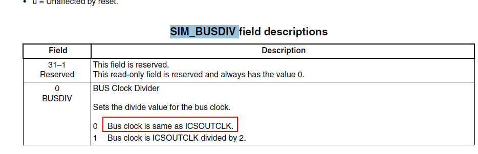

Hello Neil,
This demo is a lite version , so it default the register of SIM_BUSDIV -> BUSDIV is 0,
so the bus  clock is  the same as ICSOUTCLK , for the BDIV =0, so the ICSOUTCLK is the
same as FLL output 36MHZ.
Of course in you code ,you need configure the register "SIM_BUSDIV" .
Hope it helps
Alice
