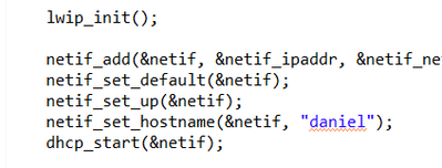

danielchen
Hi @ryan_pearson
Please refer to below for how to use hostname.
 I am using SDK 2.9,   demo lwip_dhcp_bm.
add one line
netif_set_hostname(&netif, "daniel");   to lwip_dhcp_bm.c
Enabled LWIP_NETIF_HOSTNAME   1  in lwipopts.h
My test result is OK.

ryan_pearson
I moved to the FRDM-K66F board, and still am not able to use the hostname. I'm running the frdmk66f_lwip_dhcp_bm example with the 2 lines added.
Could you let me know if you're using a dev board, and which one. And could you give me your source code, in case we have more differences?

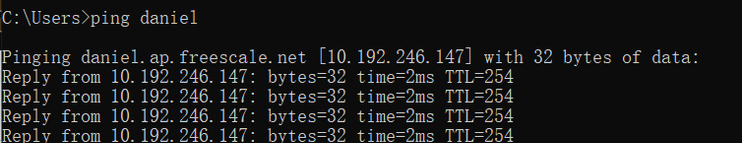

danielchen
Hi @ryan_pearson
We are using the same SDK.  I am using Win10. The difference is the DHCP server.
API netif_set_hostname only adds a member to the netif structure for a name.
It needs DNS server to translate from a name to an address.  Maybe my server done all for me.
I would suggest you take a look at below link, it seems very similar issue as yours.
http://lwip.100.n7.nabble.com/DHCP-LWIP-NETIF-HOSTNAME-1-for-IP-retrieving-td6423.html
16,497 Views
danielchen
Hi @ryan_pearson :
My pc get an ip address through DHCP, you can see there is an DNS suffix, also  a domain name.
when you ping hostname, system will search the name in DNS.  if there is no record in DNS , ping will fail.
But ping ip address will be ok.
16,585 Views
