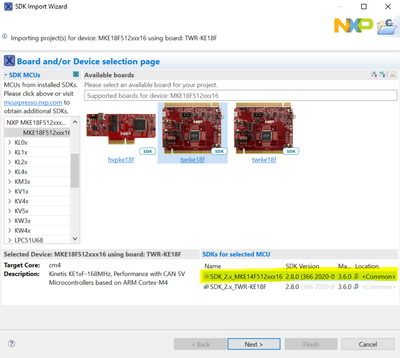

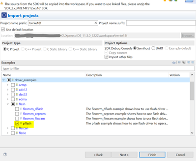

I suggest you test your device with the SDK example to check if this problem still persists. You can import the example in the MCUXpresso in the option "Import SDK examples(s)"
Please let me know the results, if you have more questions do not hesitate to ask me.
Omar

below is my result :
PFlash Example Start
 PFlash Information:
 Total Program Flash Size: 512 KB, Hex: (0x80000)
 Program Flash Sector Size: 4 KB, Hex: (0x1000)
 Flash is UNSECURE!
 Erase a sector of flash
---- HALTED DUE TO FLASH ERROR! ----
I just copy a "main" function of flash.c to my project with minor corrections,  then run it from main loop
