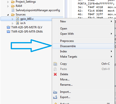

Hi, Adrian. Thank you for your reply. Are there any samples in assembly or in c with inline assembly?
6,600件の閲覧回数
adriancano
All the sample codes are in C language but you can check select the disassemble option to see the assembler code of that file, check the image below.

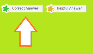

kassianikotsido
How can I mark an answer as correct? I do not see this option.
6,600件の閲覧回数
adriancano
Just below each answer you can see this two buttons.
You can click on them to select correct answer or helpful answer.

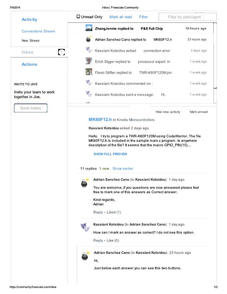

kassianikotsido
Hi, Adrian. I do not have the buttons you are refering to. Attached is how my inbox looks like.
