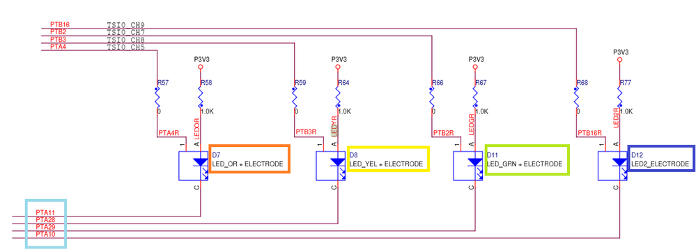

Hello.
I try to program a TWR-K60F120M using CodeWarrior. The file MK60F12.h is included in the sample main.c program. Is anywhere description of the file? It seems that the macro GPIO_PIN(10) refers to the blue LED. How will the argument  of the GPIO_PIN need to change in order to refer to the green, yellow and red lights?
12 Replies
6,913 Views
adriancano
It seems that you are running the gpio example, is that right? If it is like that then you can find in the gpio_k60.c file the next macros:
#define GPIO_PIN_MASK             0x1Fu
#define GPIO_PIN(x)                     (((1)<<(x & GPIO_PIN_MASK)))
And in the code you find the line:
GPIOA_PTOR&=~GPIO_PDOR_PDO(GPIO_PIN(10));
And this one turns the BLUE led
You can change the value of the x in the macro GPIO_PIN(x) to change the value pin of each led. According to the schematic (TWR-K60 SCH)
You can wirte:
GPIO_PIN(10) --> BLUE LED
GPIO_PIN(29) --> GREEN LED
GPIO_PIN(28) --> YELLOW LED
GPIO_PIN(11) --> ORANGE LED
I hope this information can help you.
