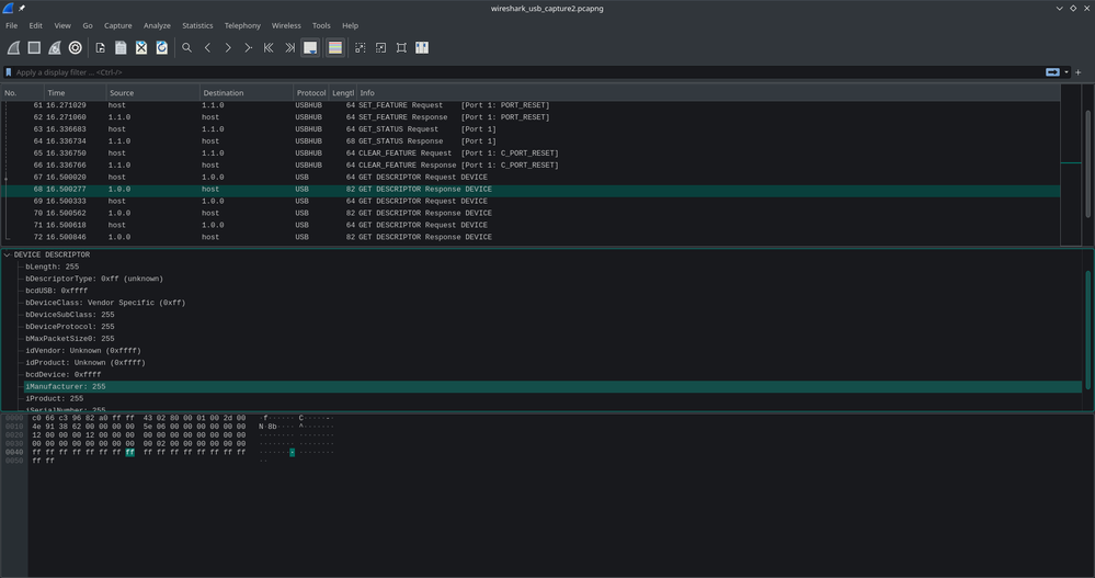

I have a board that uses the MK60FN1M0VLQ12 processor with a USB3300 PHY where I want to interface USBHS communication.
So as an initial attempt to get this USB device responsive to USB enumeration I made a Processor Expert project with an USB component and implemented a Device Descriptor response to the USB enumeration initial reset.
However the USB enumeration fails: bLength of 0 incorrect, should be 18, and all descriptor fields are empty. And doing USB packet sniffing confirms no packet is ever exchanged between the device and the host.
However in the MCU I verify that the USB1_OnDeviceReset() routine is called upon an incoming reset, and the USB1_DeviceInitEndpoint() routine used to send the descriptor finishes without errors. Consequently the USB1_OnDeviceSetupPacket() routine is never called.
What am I doing wrong? I'm wrting my main.c and Events.c down here as well as attaching the project.

I had forgotten to make an update to conclude this post.
Finally, there were 2 issues:
  • the device descriptor struct being declared as const, making it be place in the .text memory section and thus not reachable by the DMA.
  • the USB cable had a few centimeters of flying wires that disturbed the communication while on High Speed

It turns out setting the device data rate parameter of the USB PE component to "Full Speed" instead of "Dual Speed" makes the device pass the reset part of the enumeration, receiving a setup packet.
However after implementing basic setup packet handling, I can't seem to send packets to the host, even though all routines finish with no error.
Also from what I understand configuring the USB PE component like this forces the communication to be in USB Full Speed instead of High Speed, which I'm not excited about since in my application I was looking for the highest data throughput possible...

I have reviewed the documentation on the USB HS OTG Controller module from the reference manual and this document on the EHCI data structures, which are used in the PE module, as well as done some extensive debugging but have not been able to find the issue.
I have been using FS since it gets further into the enumeration. I find it hard to be a hardware problem since I notice receive a well formed setup packet in the MCU. From the host side I find, through USB packet sniffing, that I do seem to send packets from the MCU, but my responses are filled with FFs.
@jiri_rezler  I've seen you resolve a similar issue with an Internal USB module for the MK64 on Processor Expert. Would you have an idea for my issue?
I've made small changes to my project so I'm attaching it again.

LRawlyk
I want to use USB 2.0 HS capabilities to dump large external NAND Flash devices, so I'm using the USB3300 PHY which is supposedly HS compatible and setup the PE USB module SIE_Module setting as USBHS.
