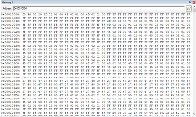

I am using MKE16F256VLL16
Even if I execute the "Erase Flash Sector Command" of the FTFE function, the flash is not erased normally.
The sector you want to erase is the memory starting at 0x00010000
FTFE execution is done from RAM.
The execution result is error free.
However, when I check the memory, it is erased in spots.
Please tell me how to solve this problem

uint8_t FTFE_CommandExecute() __attribute__((section(".ARM.__at_0x20000000")));
    FTFE->FSTAT |= ( FTFE_FSTAT_RDCOLERR(1) | FTFE_FSTAT_ACCERR(1) | FTFE_FSTAT_FPVIOL(1) );
    FTFE->FSTAT |= FTFE_FSTAT_CCIF(1);
    while( (FTFE->FSTAT & FTFE_FSTAT_CCIF_MASK) ){
        __asm("NOP");
    while( !(FTFE->FSTAT & FTFE_FSTAT_CCIF_MASK) ){
        __asm("NOP");
    return FTFE->FSTAT;
main()
    address=0x00010000;
    FTFE->FCCOB0 = 0x09;
    FTFE->FCCOB1 = (address>>16) & 0x000000FF;
    FTFE->FCCOB2 = (address>> & 0x000000FF;
    FTFE->FCCOB3 = address & 0x000000FF;
    __disable_irq();
    FTFE_CommandExecute();
    __enable_irq();
If you break here and check the FLASH, it will look like the image above.
