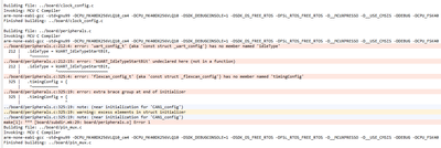

When using the SDKs for the MK40DX256 and MK60DN512 devices, I get the following warning/error (and build fails due to differing structures etc):
Unsupported version of the I2C Driver in the toolchain/IDE project. Required: 2.0.5, actual: 2.0.3.
Unsupported version of the UART Driver in the toolchain/IDE project. Required: 2.1.5, actual: 2.1.4.
Unsupported version of the FLEXCAN Driver in the toolchain/IDE project. Required: 2.2.3, actual: 2.2.0.
The SDKs are the latest available v2.2.0, and the MCUXpresso IDE is v11.6.0.
Is there later SDKs hidden away (I cant find any), or a different version of IDE that needs to be used, or a magic setting which needs enabled...?
Thanks in advance
Gary

Firstly the MEX files are created using MCUXpresso Config Tools version 12.0.
A project is then created in MCUXpresso IDE version 11.6.0, with the MEX file dropped into this.
I have attached the MEX file to this message - it does not contain commercially sensitive information.
Within the MCUXpresso IDE, in I get:
During compilation, also within MCUXpresso IDE, I get:
Also, the IDE keeps changing the runtime library to RedLib from NewLib, which also breaks the build as RedLib does not support complex numbers which we require.
Is there a recommended workflow to avoid such problems, or a tweak to a .cproject or .mex file, etc?

I tried to recreate everything from within IDE only (skipping the Xpresso Tools), but to no avail. Then I came across this:
Latest UART Driver for Kinetis K60 - NXP Community
...which described the same problem but only for UART. I tried this (selecting "add component instance" instead of just clicking on item); and I get the option of which UART version to add. This works.
However, the CAN and I2C drivers dont give this option.
I then reverted to Xpresso IDE 10.0.0 and used Tools v12.0 for MEX editing and also got I2C to work; but still lacks CAN (still complains about versions).
This is obviously a mismatch between design tools and SDK versions, and as the K40 & K60 are older devices, may never be resolved in any new version of the tools.
I'll persist on different tool version permutations until I find something which "ticks all boxes".
