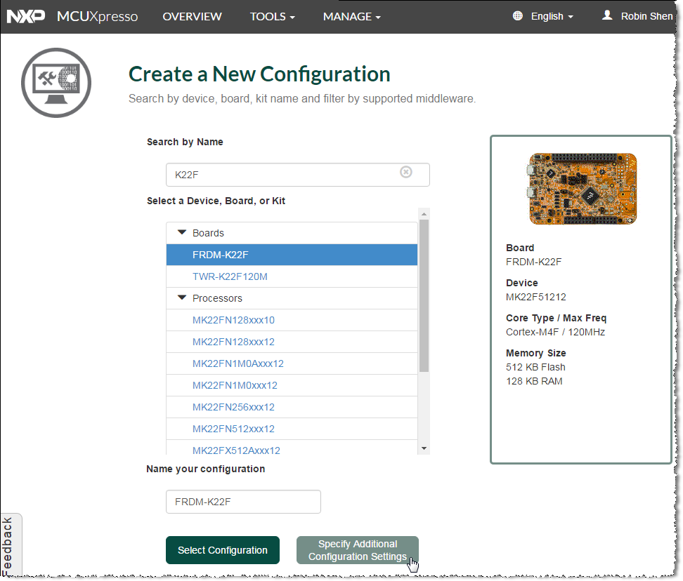

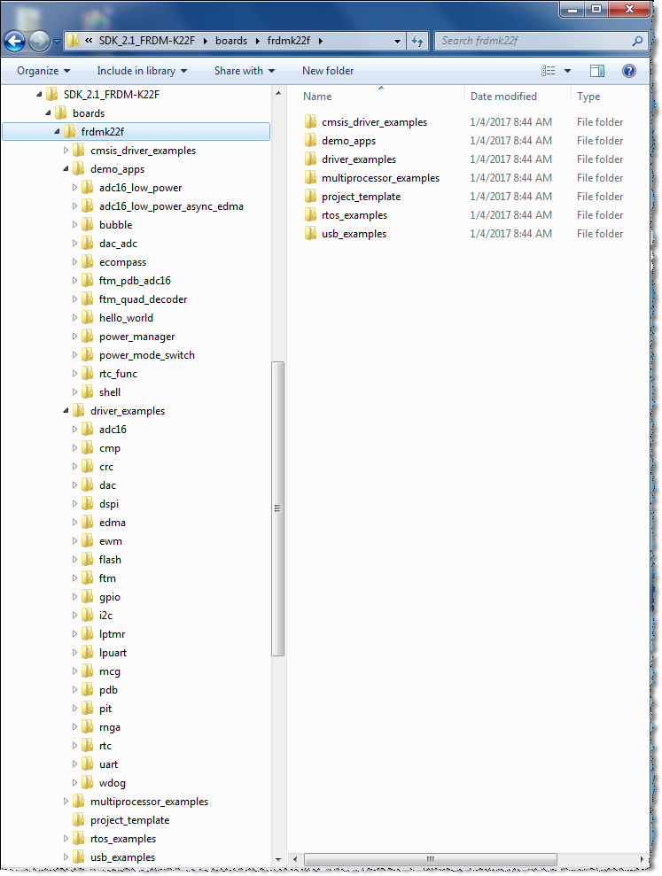

We recommend you using Kinetis Design Studio IDE and Software Development Kit for Kinetis MCUs.
There are a lot of examples in SDK_2.1_FRDM-K22F you can refer.
Search 'K22F' then select FRDM-K22F board.

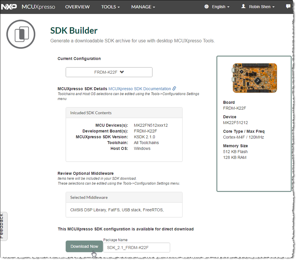

After specify additional configuration settings, you can download SDK_2.1_FRDM-K22F.
You can getting start with KSDK and KDS from reading below:
 "How to start with KSDK"  and "KDS Document List".

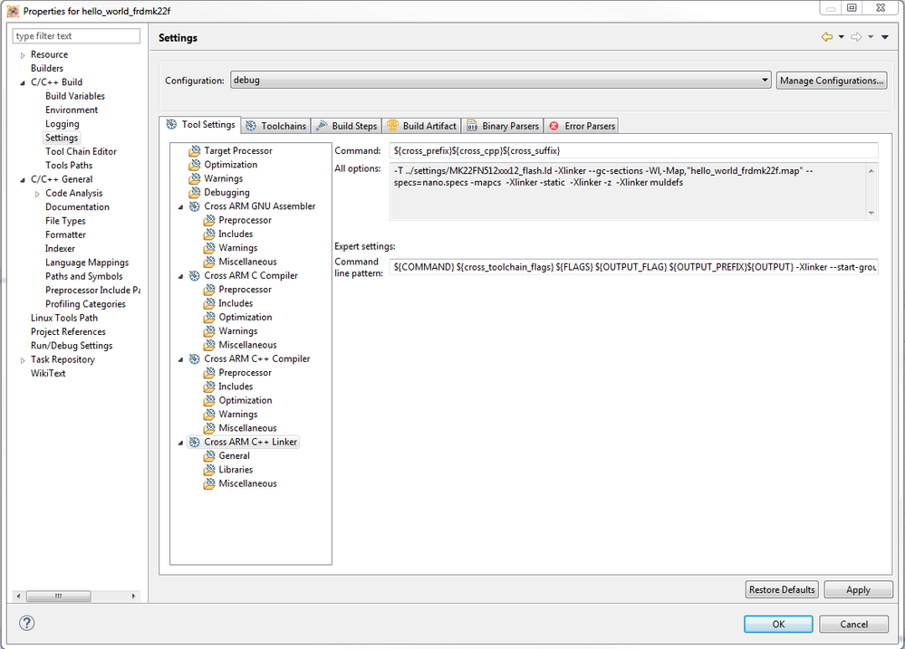

I am using Kinetis Design Studio Version: 3.2.0.
I imported the Hello World code.  I change Hello World to Hi Brian.
I compiled it with success.  However, I don't see a .bin file that I can drop into my MBED folder.
Can you tell me what I'm doing wrong?

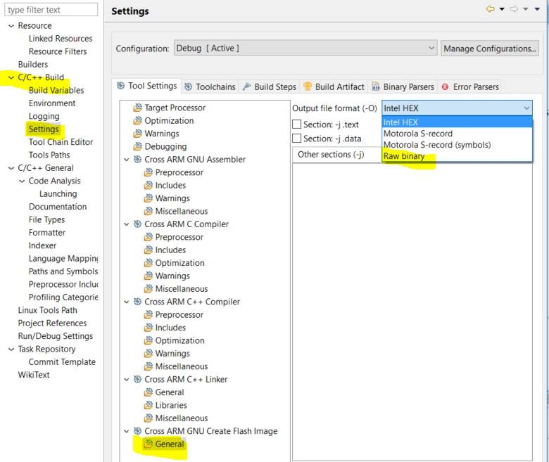

mjbcswitzerland
Specialist V
Brian
You can find this in the properties. Go to the tab shown below and select a Raw binary output:
A more flexible approach is however to add a post-build step which coverts to a number of different formats (a bat file that uses objcopy to do this) because KDS only allows one to be selected at a time.
For more advanced work you would normally also want to combine applications with a boot loader (for factory programming) or encrypt the content if your product uses code protection, which can also be done in the same step without having to think about it (or forgetting to do it).
I followed the steps and I see I'm missing "cross ARM GNU create flash image:"
I'm wondering if I didn't install another program the provides this option?
