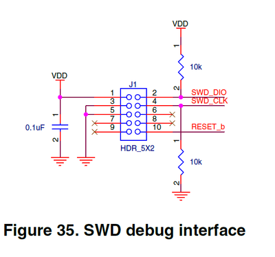

I have a design with Kinetis® MK22FN256VMP12 MCU, the schematic is attached.
It's a simple add-on board, with just the MCU, a few components, and connectors to connect to the host board and external programmer/debugger.
I have a problem with not being able to detect the MCU with the programmer/debugger.
This is a case when the add-on board is mounted to the host board, and also when the add-on board is just connected to the programmer and powered from it as well.
I am using J-Link programmer and have confirmed its functionality and connections with another Kinetis MCU. I have also confirmed the host functionality with a similar add-on board with a different MCU.
I have not excluded possible soldering problems, since it is a 64-MAPBGA footprint, but would like to exclude design mistakes before dealing with soldering.
I would appreciate it if anyone could do a design review and let me know if there is anything that could be a cause of this problem.

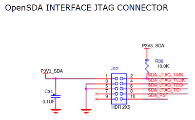

Pavel_Hernandez
Hello, I recommend reviewing this thread that maybe could help you.
Design Considerations for Debug - NXP Community
And suggest based on the design of the EVK board.

NenadJ
Hello Pavel,
Thank you for the fast response, I added 10k pull-up resistor to SWDIO line, and 10k pull-down resistor to SWCLK line.
That didn't help, let me know if there is anything else.
Nenad

tomas_voda
Please check the SWD connection.
In schematic there are no pull-ups/downs.
Can you please share schematic and device type which is working on your side?

Pavel_Hernandez
The most common error is the length of the cable, the pull ups and caps for the noise, and the voltage. Could you share a picture of your setup?
Pavel
