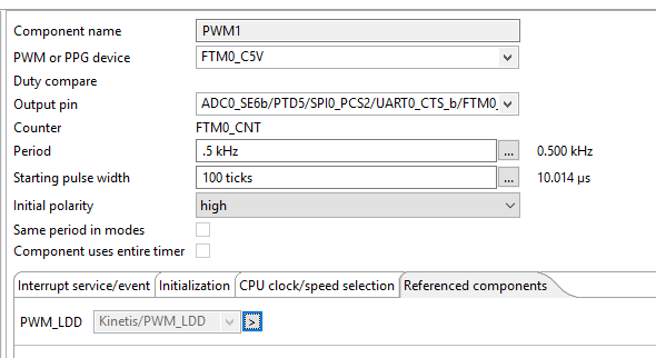

Hi, I'm using the PWM component and assigned it to PTD5(Pin 62).  I also have a 'heartbeat' led assigned to PTC1(Pin 44) that blinks every 10 seconds.
When I change the Period for the PWM it also has a direct impact on the heartbeat.
Below you'll see the Period is .5kHz.  If I change to 1kHz, my heartbeat changes also and blinks every 5 seconds.

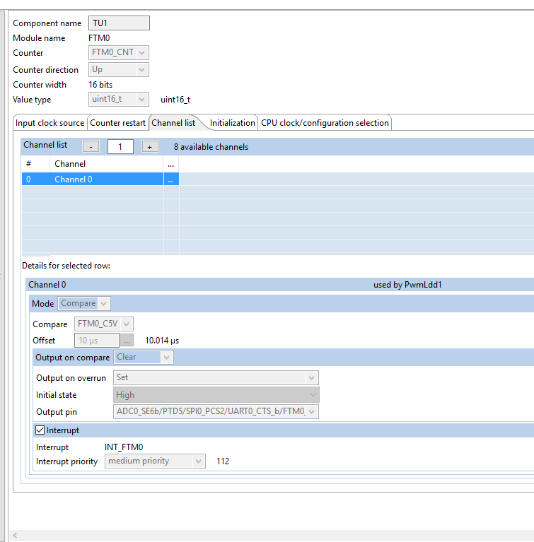

TU1:TimerUnit_LDD is assigned to the PWM:

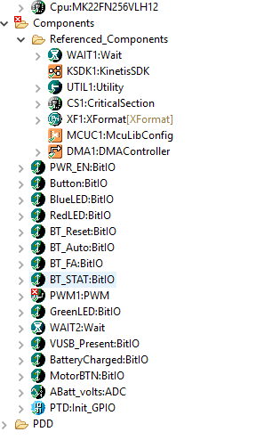

To determine if TU1 had an affect on any other components I removed it from my project to determine which components were affected by it:
As you can see above, only PWM1:PWM was affected.

PWM from the FlexTimer is driven by the bus clock or the fixed clock MCGFFCLK (unless the clock is from an external pin) and an optional pre-scaler, so as long as some setting is not adjusting your main clock or bus clock divider (or sharing a FlexTimer) I also don't see the relationship at the moment.

Hi Mark,  TU1 is only used for the PWM.

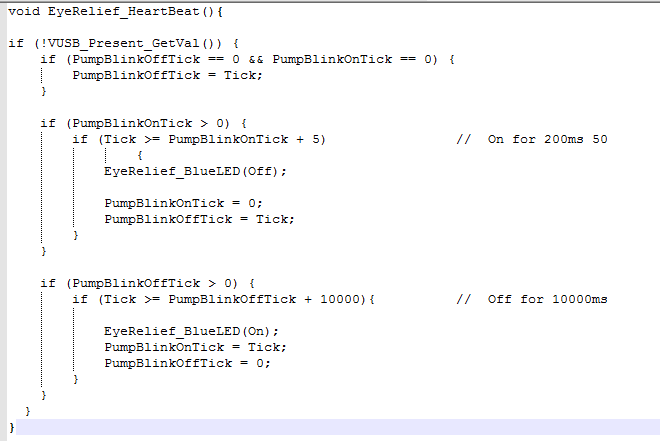

The code for my heartbeat function is below.
I did inherit this code from an old co-worker.  If it's timer driven or software driven based on a Tick, I'm not certain.
I've been trying to figure that part out without success.
The enable/disabled contents within TU1 is listed below:

Search for the variable Tick and see where it is being "incremented". I suspect it will be in a timer routine (usually Systick interrupt).
