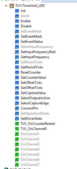

Hi Mark,  TU1 is only used for the PWM.
The code for my heartbeat function is below.
I did inherit this code from an old co-worker.  If it's timer driven or software driven based on a Tick, I'm not certain.
I've been trying to figure that part out without success.
The enable/disabled contents within TU1 is listed below:
How can I confirm if a "Tick interrupt" is being used?  Note, I have no external clocks coming into the uC.

Search for the variable Tick and see where it is being "incremented". I suspect it will be in a timer routine (usually Systick interrupt).
