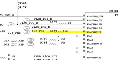

My customer using the MK22FN1M0AVLH12 in his design (I can provide the schematic if needed).
And he used a buffer (74AVC4T774) on the JTAG signals – partly schematic attached below:
74AVC4T774 on the JTAG signals74AVC4T774 on the JTAG signals
They have trouble to programming the MCU when they use the buffer.

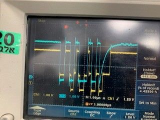

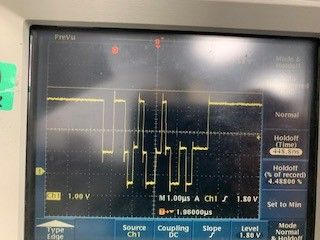

Also when we probe the TMS signal after the buffer we saw the following – see attachments
TMS after BufferTMS after Buffer

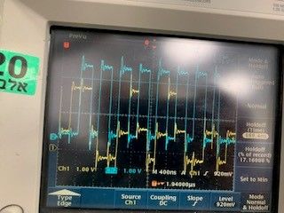

See also during or after the programming fails the  TMS toggle like clock for a period of time – see attached
TMS after Buffer and TCKTMS after Buffer and TCK

Hello, could you tell me about your connector, the Reset_b is controlled by the Debugger? tell me about the state of the NMI. I attached the KQRUG has some recommendations.
Pavel

The reset _b connects to the debugger
In the schematic, it connects to the reset device that controlled the device pin but as part of the debug I connect it straight to the connector
The NMI pin connects with an external Pull up of 10K

the signal of the JTAG in the oscilloscope? -> [shai]
TMS after Buffer and TCK TMS after Buffer and TCKTMS after Buffer and TCK
TMS after Buffer TMS after BufferTMS after Buffer
TMS after Buffer and TMS before buffer
TMS after Buffer and TMS before bufferTMS after Buffer and TMS before bufferTMS after Buffer and TMS before bufferTMS after Buffer and TMS before buffer
