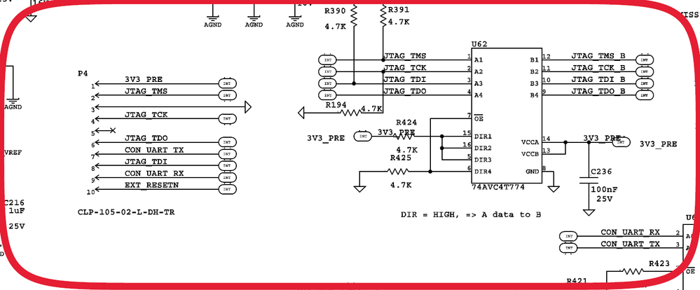

Hello team,
My customer using the MK22FN1M0AVLH12 in his design (I can provide the schematic if needed).
And he used a buffer (74AVC4T774) on the JTAG signals – partly schematic attached below:
74AVC4T774 on the JTAG signals74AVC4T774 on the JTAG signals
They have trouble to programming the MCU when they use the buffer.
BTW, When they bypass the buffer the programming pass successfully.

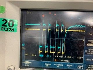

Also when we probe the TMS signal after the buffer we saw the following – see attachments
TMS after BufferTMS after Buffer
See also during or after the programming fails the  TMS toggle like clock for a period of time – see attached
TMS after Buffer and TCKTMS after Buffer and TCK
Please advise back what could be the issues, waiting fro your kind feedback, thanks.

Hello, could you tell me about your connector, the Reset_b is controlled by the Debugger? tell me about the state of the NMI. I attached the KQRUG has some recommendations.
Pavel

shai_b
Senior Contributor II
@Pavel_Hernandez Hello
The reset _b connects to the debugger
In the schematic, it connects to the reset device that controlled the device pin but as part of the debug I connect it straight to the connector
The NMI pin connects with an external Pull up of 10K
Do you want me to measure it?
Waiting for your kind feedback, Thanks a lot.
Shai

Hello, sorry about this inconvenience, could you available to share an image with the signal of the JTAG in the oscilloscope? this is to review the behavior at a time to prepare to flash.
What kind of debugger are you using?
Are you using a special flash config?
Are you using a custom bootloader?
What kind of IDE are you using for flashing or how you are trying to flashing? I mean with a command or other method.
Pavel

shai_b
Hi @Pavel_Hernandez,
Please find my comment below:
the signal of the JTAG in the oscilloscope? -> [shai]
TMS after Buffer and TCK TMS after Buffer and TCKTMS after Buffer and TCK
TMS after Buffer TMS after BufferTMS after Buffer
TMS after Buffer and TMS before buffer
TMS after Buffer and TMS before bufferTMS after Buffer and TMS before bufferTMS after Buffer and TMS before bufferTMS after Buffer and TMS before buffer
What kind of debugger are you using? -> [shai] USB Multilink Universal
Are you using a special flash config? -> [shai] We got the files from our partners, they do not know.
Are you using a custom bootloader? -> [shai] MCUXpressoIDE 11.6.1
