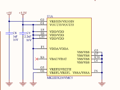

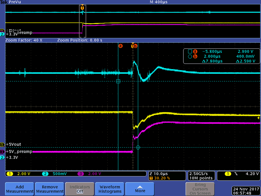

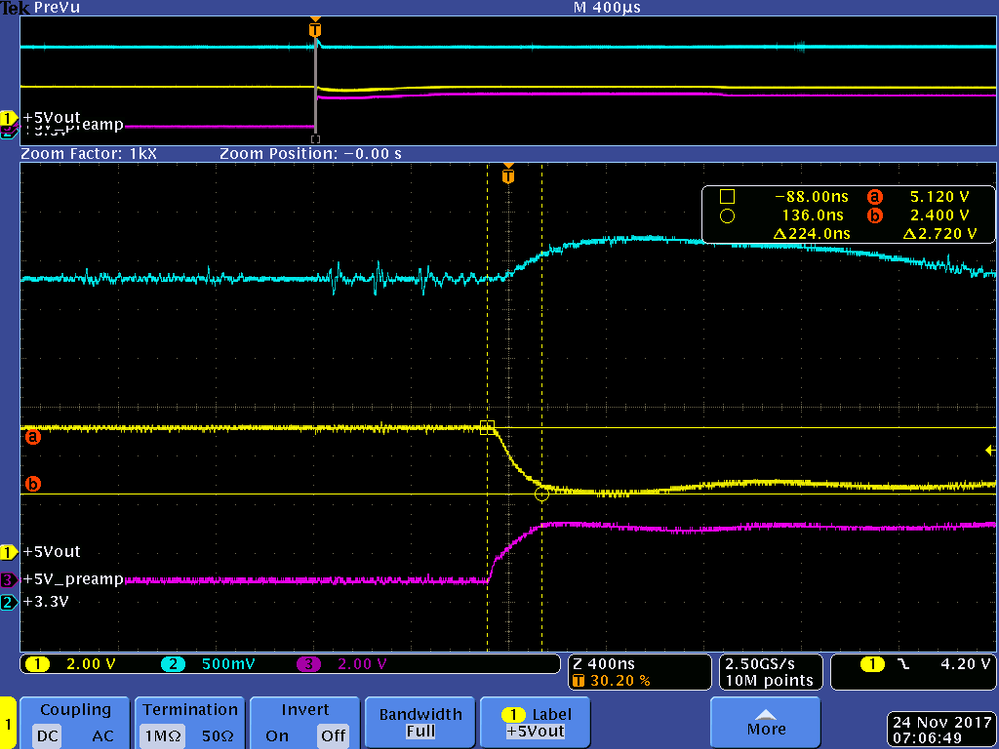

huijiejiang
We are using the internal regulator, and VOUT33 output voltage(+3.3V on the schematic) rise to 3.8V when there is an fast voltage dip on VREGIN("+5V" on the sch, "+5Vout" in the graph), see below for the sch and graph.
We guess that is because of the PSRR, but we cannot find the PSRR parameter in the datasheet...
What is the root cause and how can we improve the performance?

xiangjun_rong
Hi, HuJie,
The VDD power supply ranges from -0.3V to 3.8V, so I think it is okay.
As you know that the VOUT33 is  the internal regulator output, the internal regulator inputs 5V, it is not related to the PSRR(power supply rejection rate). how about  using different capacitor on the VOUT33 pin, which can ranges from 1.76uF to 8.16uF.
Hope it can help you
Xiangjun Rong
4,297 Views
huijiejiang
Hi Xiangjun,
Thanks for your quickly reply.
I have tried your suggestion to add additional capacitors to C9 and made it as 4.4uf, 6.6uf..., and did the test with the same method, but there was no improvement.
Based on the test, the fluctuation of the VOUT3.3 is reduced when the voltage dip is reduced and seams not so related to the capacitor, which meets the requirement of the datasheet.
Here is the question,
1) Do you have the PSRR of the regulator?
2) Is there any additional requirement for the VREGIN that related with VOUT3.3?

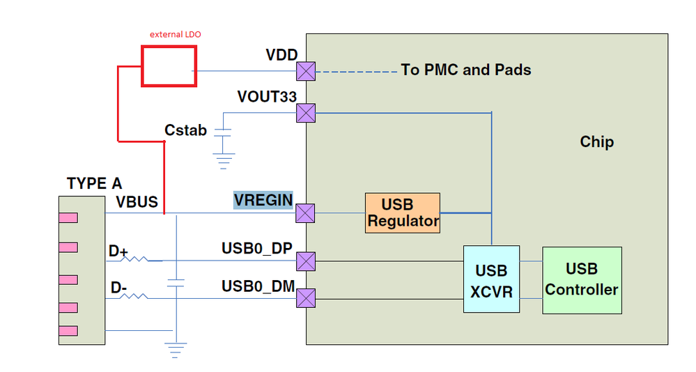

huijiejiang
Hi Xiangjun,
Is there any update?
regarding the internal regulator,
We design the MCU as a USB device, if we use an external LDO, how to treat the VREGIN and VOUT3.3?
Do we MUST to, as the below picture,
1) connect VREGIN to VBUS
2) add Cstab to VOUT3.3(2.2uf? can that capacitor be used a smaller value one?)
3) connect VDD to external LDO output
Can we ONLY use the external LDO and just leave away(just float the VREGIN and VOUT3.3) the internal regulator?
