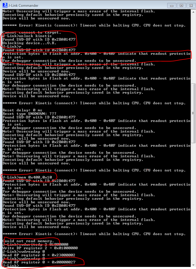

kerryzhou
Hi olivier capron,
   If the chip mass erase still enabled, the chip can do the mass erase, then you can unlock it.
  Now, please use the JLINK debugger with the JLINK commander window, follow my step:
1. connect the chip, choose the correct part number.
2. input: unlock kinetis
Wait the unlocking device is ok
3. input:r
to reset the chip.
4.input:mem 0x400,0x10
Just to check the flash configuration field, to check the flash data.
Please follow my step, and post your result.
Kerry

oliviercapron
Thank you for your support.
Unfortunately, as mentioned in our question, we already had tried this without success. Please find attached a capture showing the result.
As already explained, we tried to manually trigger a mass erase using the MDM-AP Control register, which is accessible. But the mass erase does not occur. It seems that the core is constantly resetting and thus cannot perform the erase. What do you think?
