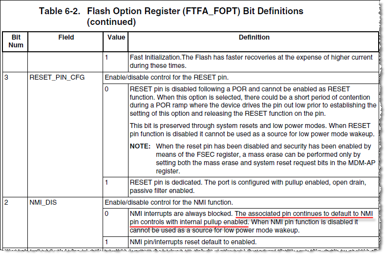

We currently have an LED driver assigned to the PTA4 pin, with NMI disabled, and the LED will come on until we can turn off the pullup when configuring the I/O port after RESET.  Looking for a faster way to accomplish this so that all LEDs assigned to output ports come on at the same time.

Hi Tim,
Although the NMI function on PTA4 can be disabled by clear the FTFA_FOPT[NMI_DIS]. The associated pin continues to default to NMI pin controls with internal pullup enabled. You still need to turn off the pullup when configuring the I/O port after RESET.
I am afraid you can't achieve that by software.
Have you ever considered add external pull-up resistors at all these pins?
Or don't use PTA4 pin.
