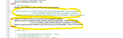

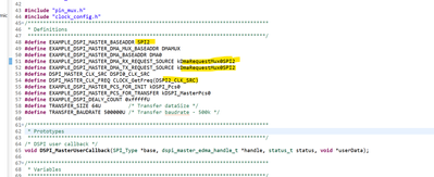

I'm trying to transmit data via SPI2 peripheral, using DMA in my MK21FX512AVMD12. I'm looking at the drivers examples (twrk21f120m_dspi_edma_b2b_transfer_master, twrk21f120m_dspi_half_duplex_edma_master)....and I see diferences when I use SPI2 instead SPI0. In those examples for the SPI0 peripheral the callback is called adequately, but when I change to SPI2, it is not called. These are the changes that I apply:
In the edma_spi driver it is clear that both peripherals are different, because SPI0 has separate DMA request and SPI2 don't.
Do I have to change anything else in order to use SPI2?

I could not get the twr-k21 but I make some tests with the frdm-k22 this is the code I modified and tested.

#define EXAMPLE_DSPI_MASTER_BASEADDR              SPI1
#define EXAMPLE_DSPI_MASTER_DMA_MUX_BASEADDR      DMAMUX
#define EXAMPLE_DSPI_MASTER_DMA_BASEADDR          DMA0
#define EXAMPLE_DSPI_MASTER_DMA_TX_RX_REQUEST_SOURCE kDmaRequestMux0SPI1
//#define EXAMPLE_DSPI_MASTER_DMA_TX_REQUEST_SOURCE kDmaRequestMux0SPI0Tx
#define DSPI_MASTER_CLK_SRC                       DSPI1_CLK_SRC
#define DSPI_MASTER_CLK_FREQ                      CLOCK_GetFreq(DSPI1_CLK_SRC)
#define EXAMPLE_DSPI_MASTER_PCS_FOR_INIT          kDSPI_Pcs0
#define EXAMPLE_DSPI_MASTER_PCS_FOR_TRANSFER      kDSPI_MasterPcs0
#define EXAMPLE_DSPI_DEALY_COUNT                  0xfffffU
#define TRANSFER_SIZE     64U     /* Transfer dataSize */
#define TRANSFER_BAUDRATE 500000U /* Transfer baudrate - 500k */

    /* DMA Mux setting and EDMA init */
    uint32_t masterRxChannel, masterTxChannel;
    edma_config_t userConfig;
    masterRxChannel = 0U;
    masterTxChannel = 1U;
/* If DSPI instances support Gasket feature, only two channels are needed. */
#if (!(defined(FSL_FEATURE_DSPI_HAS_GASKET) && FSL_FEATURE_DSPI_HAS_GASKET))
    uint32_t masterIntermediaryChannel;
    masterIntermediaryChannel = 2U;
#endif
    /* DMA MUX init */
    DMAMUX_Init(EXAMPLE_DSPI_MASTER_DMA_MUX_BASEADDR);
    DMAMUX_SetSource(EXAMPLE_DSPI_MASTER_DMA_MUX_BASEADDR, masterRxChannel, (uint8_t)EXAMPLE_DSPI_MASTER_DMA_TX_RX_REQUEST_SOURCE);
    DMAMUX_EnableChannel(EXAMPLE_DSPI_MASTER_DMA_MUX_BASEADDR, masterRxChannel);
#if (defined EXAMPLE_DSPI_MASTER_DMA_TX_REQUEST_SOURCE)
    DMAMUX_SetSource(EXAMPLE_DSPI_MASTER_DMA_MUX_BASEADDR, masterTxChannel, (uint8_t)EXAMPLE_DSPI_MASTER_DMA_TX_REQUEST_SOURCE);
    DMAMUX_EnableChannel(EXAMPLE_DSPI_MASTER_DMA_MUX_BASEADDR, masterTxChannel);
#endif

I think this could help you to port in the k21.
Pavel

Hi @Pavel_Hernandez , thanks for the answer. I already try to use only one macro (disabling the RX part), but it is not working. The callback is not being called:
5,579件の閲覧回数
Pavel_Hernandez
I suggest reviewing the code because in the original code there are using 2 sources of the DMAMUX but with the SPI2 you need to modify your code to use only one source.
This configuration handler is for an inexistent source.
Pavel
Pavel
5,515件の閲覧回数
DaniMartin
thanks!! It works in MK21 for both SPI1 and SP2.
5,612件の閲覧回数
Pavel_Hernandez
I review the example and I confirm something in the Reference Manual in the section [Table 3-25. DMA request sources - MUX 0] you can see the sources of the example in yellow.
But the SPI2 only have 1 source for transmit or Receive, and you define tow macros but only need one.
#define EXAMPLE_DSPI_MASTER_DMA_RX_TX_REQUEST_SOURCE kDmaRequestMux0SPI2
Try it and if you have more questions please let me know.
Pavel
