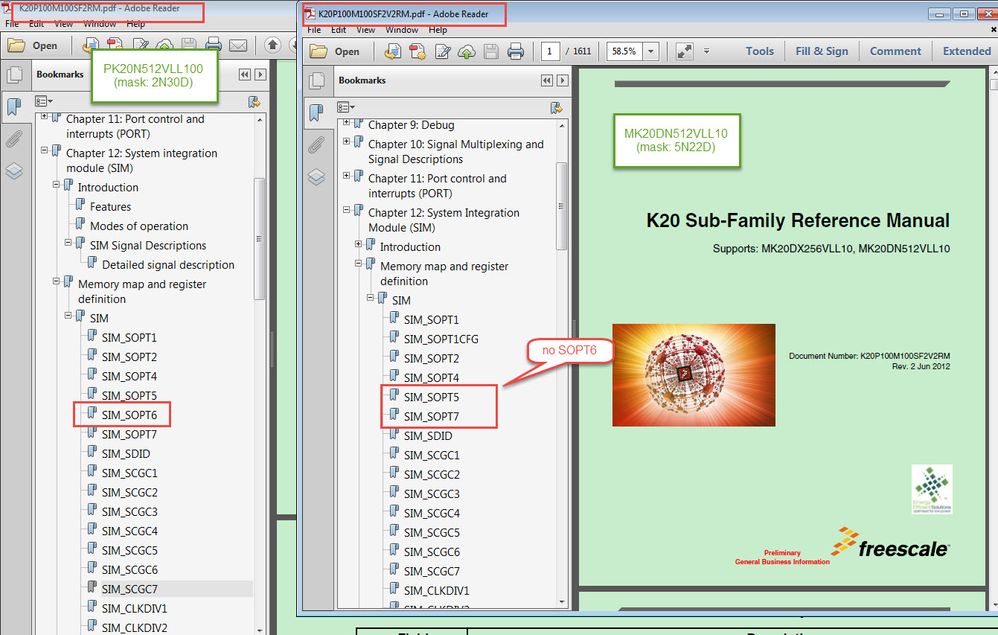

I have developed a application with K20 some years ago. I have about 100 devices thas is woriking fine. I have just mounted other batch and devices don't work.
I have noted that old items have PK20N512VLL100 (mask: 2N30D) and new ones have MK20DN512VLL10 (mask: 5N22D).
I can program devices but the SW don't run. In debug mode it goes in:
PE_ISR(Cpu_Interrupt)
  /* This code can be changed using the CPU component property "Build Options / Unhandled int code" */
  PE_DEBUGHALT();
  return;
It seems an unmanaged interrupt, but I check it and all seems OK.
I need some helps to find the trouble and fix it.

Hi Mirko Manetti,
     I have found the problem, your hardfault happens on MK20DN512VLL10 (mask: 5N22D), is that right?
    It is caused by the different silicon reversion:
PK20N512VLL100 (mask: 2N30D): rev1, the reference manual is K20P100M100SF2RM.pdf
MK20DN512VLL10 (mask: 5N22D): rev 2, the reference manaul is K20P100M100SF2V2RM.pdf
You can find the reason from this shortscreen:
MK20DN512VLL10 (mask: 5N22D) don't have the SIM_SOPT6, so when you operate it, it will enter in hardfault.
About the difference of 100M rev1 and rev2, you can refer to our application AN4445.pdf.
http://cache.nxp.com/files/32bit/doc/app_note/AN4445.pdf?fsrch=1&sr=1&pageNum=1
So you can't use the PK20N512VLL100 (mask: 2N30D) code in MK20DN512VLL10 (mask: 5N22D) directly, there has a lot of difference.
Wish it helps you!

I have just check my application fault according your indication but I can't find the reason of the hardware fualt. It seems a "GPIO_PTE_SetFieldValue" call the reason but If I put a breakpoint at "GPIO_PTE_SetFieldValue", the program doesn't arrive at this breakpoint, so the truoble should be in PE_low_level_init():

a StepByStep debug  fault line is:
SIM_SCGC7 |= (uint32_t)0x04UL;
but I don't understand the reason of the fault.......

mntmrk
Hi Jingjing,
I have just add suggested code but anything change and sw still doesn't work:
void PE_low_level_init(void)
      /* Initialization of the SIM module */
//#ifdef NO_INIT
  SIM_SCGC5|=SIM_SCGC5_PORTE_MASK;
  /* PORTA_PCR4: ISF=0,MUX=7 */
  PORTA_PCR4 = (uint32_t)((PORTA_PCR4 & (uint32_t)~0x01000000UL) | (uint32_t)0x0700UL);
  /* SIM_SOPT6: RSTFLTEN=0,RSTFLTSEL=0,??=0,??=0,??=0,??=0,??=0,??=0,??=0,??=0,??=0,??=0,??=0,??=0,??=0,??=0,??=0,??=0,??=0,??=0,??=0,??=0,??=0,??=0,??=0,??=0 */
  SIM_SOPT6 = (uint32_t)0x00UL;        /* Set reset pin filter */
  /* SIM_SCGC7: MPU=1 */
        /* Initialization of the MPU module */
  /* MPU_CESR: SPERR=0,VLD=0 */
  MPU_CESR &= (uint32_t)~0xF8000001UL;
Steb by step debugging fails at:
So this instruction o the previews one are suspected.....
anyway if I skip:
   It seems work properly.....
it seems me very strange!
Mirko

kerryzhou
Hi Mirko Manetti,
Wish it helps you!
If you still have question, please contact me!
Jingjing
4,997 Views
mntmrk
Now it's work!   thank you!
