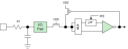

There is a document about Kinetis hardware design Tip & Tricks, please check below link for detailed info:
Kinetis Hardware Design Tip &amp; Tricks
On pins wiTh 5V ToleranT inpuTs, Too large oF a pull-down resisTor can end up wiTh >10ua leakage currenT.
Please see The datasheet for maximum resistance value allowed.
If R1 is too high, the pin level will not drop below VIL which is needed to turn off the p-channel keeper.
R1 must be low enough such that the PFET current will make this IR less than VIL when signal is grounded
Use 20uA to calculate initial R1 value & pick lower value

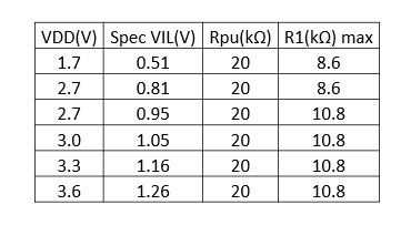

VDD(V)
Spec VIL(V)
R1(kΩ) max
1.7
0.51
25.5
2.7
0.81
40.5
2.7
0.95
47.3
3.0
1.05
52.5
3.3
1.16
57.8
3.6
1.26
63.0
If using the internal Pull-up resistor (20kΩ to 50kΩ), Use min Rpu value to calculate initial R1 value & pick lower value:
