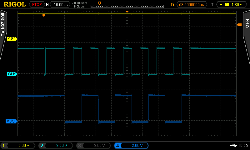

if I try to use the SPI0 of a MK20DX256 with disabled TX and RK FIFO it doesn't work.
I tried nearly everthing. I use the Config-Tool of Prozessor Expert (only the Init-Module) to set the Init-Parameter.
But regardless what I do I got only the frame below.
I init the device (see code below) and write 0xAA the TX_DATA in PUSHR. As you can see it is transmitted but the CS is only a peak
and after this transmission I can do what I want, nothing happens anymore :-( I got no more frames until doing a reset.
Have anyone an idea?

Hi Marcus,
Try this in your transmit function:
    SPI0_PUSHR |= (0x00010000 | 0xAA);
This should assert PCS0. If that doesn't work, let me know. Thank you.
Martyn

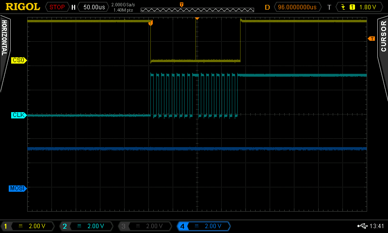

marcusguenther
Yes this works... but leaded to the next problem.
After a reset and the Hardware Init-Routine of SPI0 the TCF is always 0. I have to send a dummy frame to clear it.
Futhermore I got with this code only to frames. If I have a breakpoint between the commands and execute it step by step
each command send a frame (3 frames). Without breakpoints I got only two frames. Isn't the device already ready when the TCF
is set? Never I had such probems with a SPI device :-(
#define GET_TCF(SPI0_SR & SPI_SR_TCF_MASK)
SPI0_PUSHR = 0x000100FF;
while(!GET_TCF);
while(!GET_TCF);
while(!GET_TCF);
NOP;
(no command is sent befor this code)
2,875 Views

Hi Marcus,
Do you get the same number of frames if you remove the "while(!GET_TCF);" lines from your code? Also, are you still using your original register settings or have you changed them?
Thank you,
