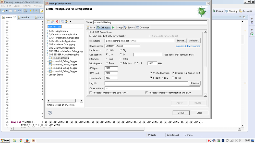

nikivendola
This is useful for you?

jorge_a_vazquez
Hi nikivendola
You're using segger j-link to debug. The Breakpoint that you showed in your image is set in the startup menu configuration. You can uncheck this breakpoint in the startup tab in the debug configuration:
You can also check the following link: https://mcuoneclipse.com/2014/10/04/emulating-eclipse-run-with-debug-configuration/
Hope this could help.
Jorge Alcala

nikivendola
I'm sorry but the debugging interface has been set by one of my prof. How do I know?
I made a sreenshot to show how it looks breakpoint.
