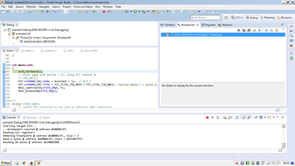

nikivendola
Thanks for your answer
I wanted to ask one more thing. I added a breakpoint but I can not take it off. At each Debug I remove him with the double click on the breakpoint or double X but to debug later reappears.
How can I do?

jorge_a_vazquez
Hi nikivendola
What debug interface are you using? and How this breakpoint appear in your breakpoint list? (windows>show views>Breakpoints). Could you please check the disassembly view and verify if the breakpoint appear there.

nikivendola
This is useful for you?

jorge_a_vazquez
Hi nikivendola

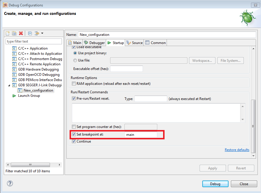

You're using segger j-link to debug. The Breakpoint that you showed in your image is set in the startup menu configuration. You can uncheck this breakpoint in the startup tab in the debug configuration:
You can also check the following link: https://mcuoneclipse.com/2014/10/04/emulating-eclipse-run-with-debug-configuration/

nikivendola
I'm sorry but the debugging interface has been set by one of my prof. How do I know?
I made a sreenshot to show how it looks breakpoint.
