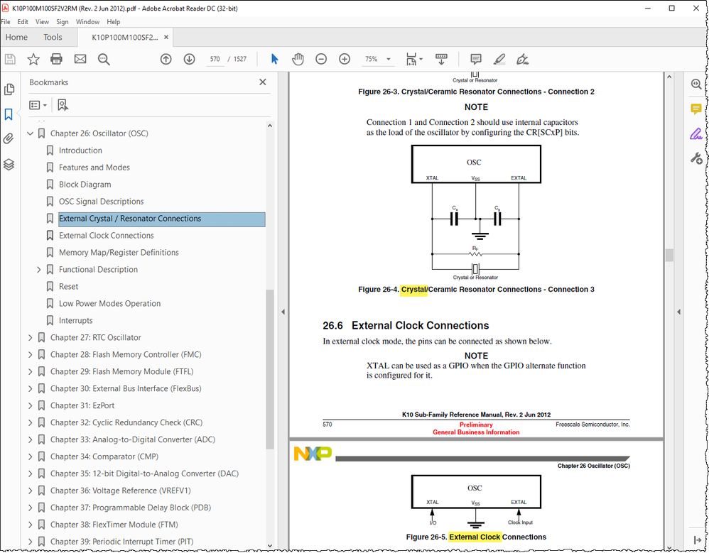

Hi davithakobyan,
Are you using an external crystal or external reference clock source?
Crystal or external reference clock.pngCrystal or external reference clock.png
Here is the difference:
In addition, you can also check if there is a matching errata.
Please check the mask of MCU, make sure the part number is MK10DN512VLL10 not MK10DN512ZVLL10
