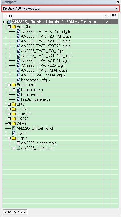

I've opened a IAR project that resides in AN2295sw. The project has some configuration files
AN2295_TWR_K60_cfg.h
AN2295_TWR_KL25_cfg.h
But if want to use MK10 chip - what file should I use? Or how should I alter the existing file?
4,967 Views
Hui_Ma
Please try with attached AN2295 software.
In IAR project, please select the [Kinetis K 120MHz Release] target:
Wish it helps.
Ma Hui

Hui_Ma
Wish it helps.
Ma Hui
4,967 Views
john71
Senior Contributor I
Thanks a lot my friend! Awesome!
