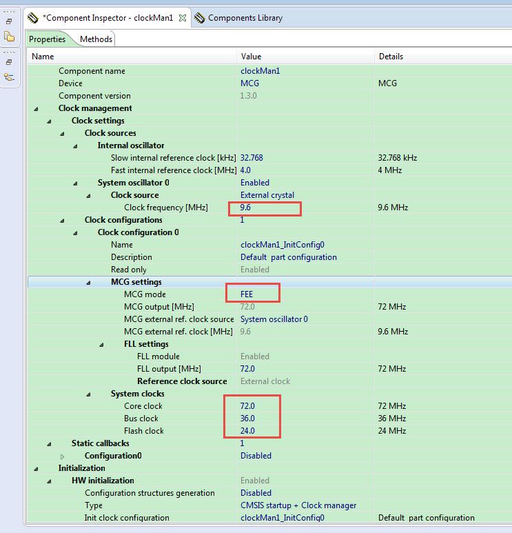

Hi Snehal,
    If you want to get:
core clock as 72MHz, bus clock as 36MHz,Flash clock as 24MHz
There has two way:

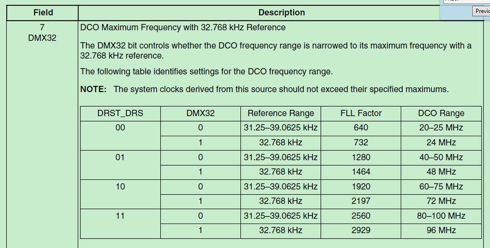

1. use FEI,  trim your internal slow frequency to 37.5.

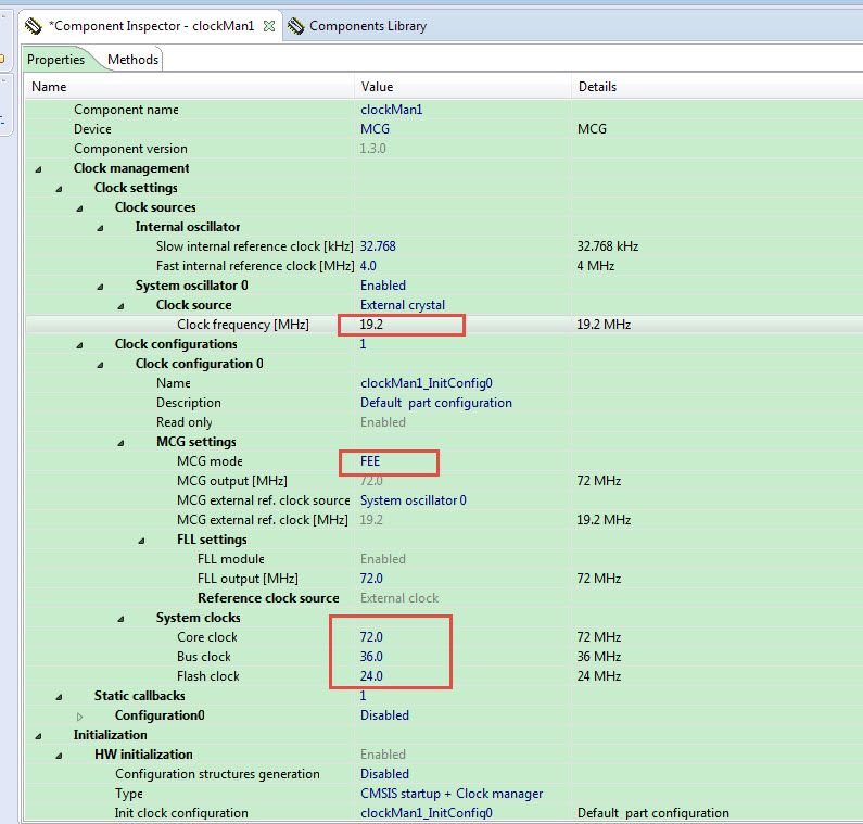

2. use FEE, but you should use 9.6Mhz or 19.2Mhz external crystal.
  The reason is:
    If you want to get 72Mhz, you need to configure your FLL input to 37.5Khz, because 37.5K*1920=72Mhz.

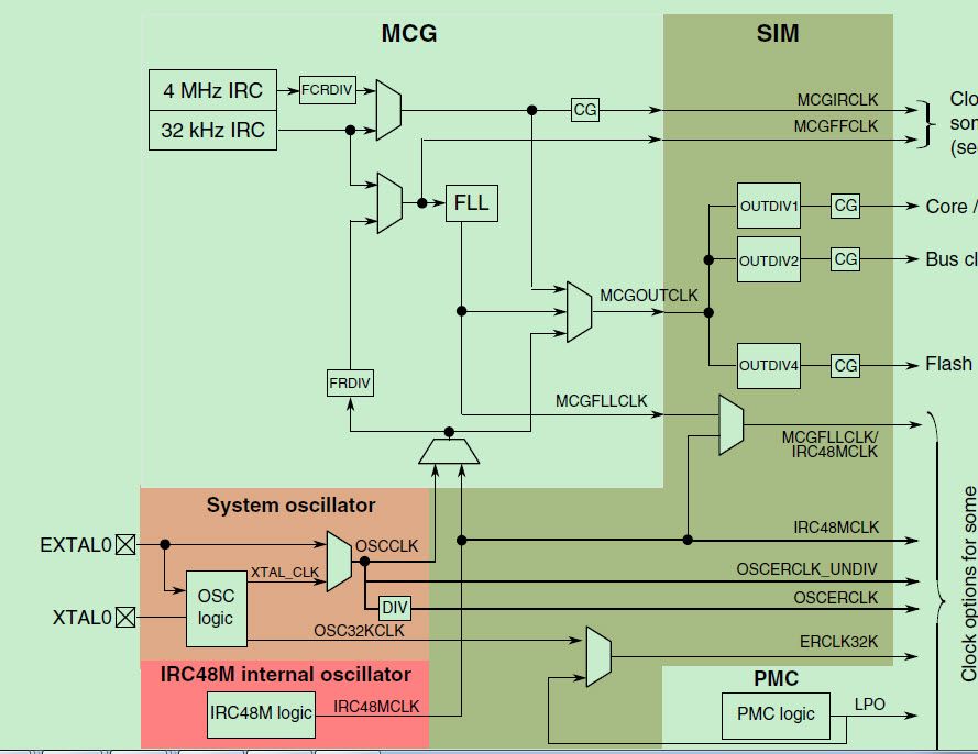

    As you know,
    FLL can choose the internal slow IRC or the oscillator which is divided by FRDIV,  the FRDIV can be: 32,64,128,256,512.
  Then, you can know that, your oscillator can be: 1.2Mhz, 2.4Mhz, 4.8Mhz, 9.6Mhz or 19.2Mhz.
    9.6Mhz and 19.2Mhz is the common oscillator frequency.
  So you can choose FEE, and use the PE kds configure it like this:
or
From the clocking diagram, you can know that, K02 just have FLL, and it doesn't have the PLL, so you don't need to do PLL settings, just do FLL settings, you can refer to the PE generated code.
Wish it helps you!
