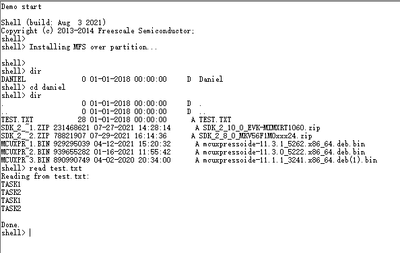

danielchen
Hi MattJCole:
I tested the demo under folder
\KSDK_1.3.0\middleware\filesystem\mfs\examples\sdcard\build\iar\sdcard_frdmk64f
with my sd card.  I had 6 files in my sd card,  the total size is more than 2.8G .
I can access the file.  could you please let me know how to reproduce your issue on my side?
