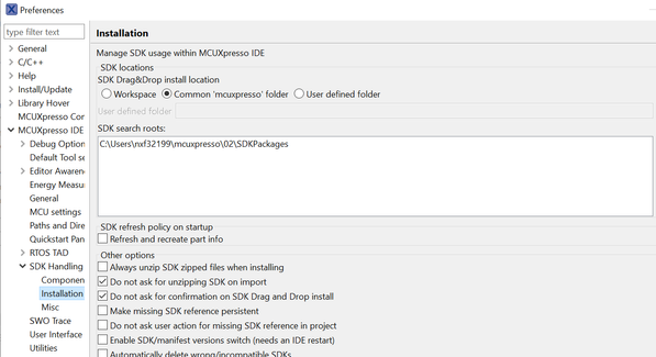

I have installed MCUXpresso IDE version 11.2.0 with FRDM-K66 SDK 2.8.0. Everything is working fine...
Today, I installed MCUXpresso IDE version 11.5.0 with FRDM-K66 SDK 11.0. It works fine...
When I close both IDEs and re-launch version 11.2.0 and it tells me that it can't find SDK2.8.0...
I have to re-install SDK 2.8.0 to make it work...
How can I set to use the specified SDK for the different IDE version as follows?

Hi @a8Chcx ,
It seems you let the two MCUXpresso share a SDK folder. You can assign different SDK folder to each IDE. It is in window->preferences
Jing
