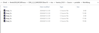

I recently upgraded to MCUXpresso v11.10.0, build 3148.  I added a new project this morning using FreeRTOS and it appears that the heap_1.c, heap_2.c, heap_3.c, heap_4.c and heap_5.c are no longer included.  This leads to undefined references to functions like vPortMalloc (and pretty much everything else memory related).
Is this on purpose?  Where should we get the new heap files?

I am sorry for misunderstanding you, the heap_x.c is located at the directory in SDK package.

That seems kind of silly since the IDE is already unzipping the SDK and copying files in.  So NXP is saying when you want to make a new project with FreeRTOS, you have to go find the SDK file, unzip it and grab these four files?

When you create a project or use the SDK example, the driver file which the example required will be copied to the project. If the driver is not used in the project, it is not copied.

Some soft of heap management is required for the FreeRTOS to compile.  These files should be copied in when selecting FreeRTOS as the OS.  They are not.  I think this is a bug.
